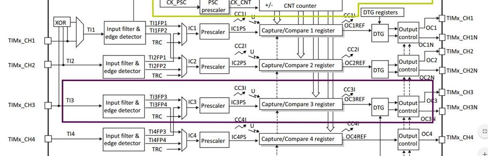

Input Capture Indirect Mode is when you want to take input from other channel. If you check out the Timer Cookbook (image from Timer Cookbook below). You will observe that TI1FP2 is connected to Channel 2, and similarly TI2FP1 is connected to Channel 1. This can also be observed with Channel 3 and 4.
Further, I found the comment from HAL.
#define TIM_ICSELECTION_INDIRECTTI (TIM_CCMR1_CC1S_1) /*!< TIM Input 1, 2, 3 or 4 is selected to be
connected to IC2, IC1, IC4 or IC3, respectively */I hope this explains the Input Capture Indirect Mode to you.
Application: You can use Channel 3 and 4, Channel 1 and 2 to get same signal.
