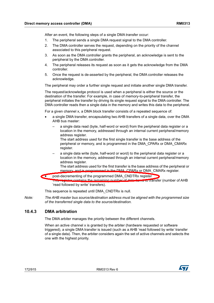

So if my reference manual says
post-decrementing of the programmed DMA_CNDTRx register
This register contains the remaining number of data items to transfer (number of AHB
‘read followed by write’ transfers)That means if I have 2 bytes buffer and the DMA have already filled 1 index at the buffer, that means CNDTR will show 1?
And when the circular buffer have been filled, then CNDTR = 0 and then directly CNDTR = 2 because not it's starting at index 0 again?
I can intepret CNDTR as how many elements it has left to write?
2021-08-21 1:08 PM
Yes.
