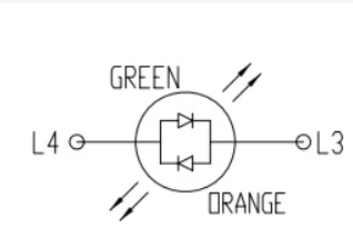

I think I've found the problem. The problem was the Ethernet connector I was using, basically the connector has LEDs that can be used in both polarities:
And this was going to disturb the polarization of pin 2, and consequently the clock was not arriving well at the PHY. After changing the connector, the LEDs light up well, I no longer have the initial error.
