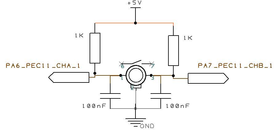

I have a big mystery, based on incremental rotary encoders. I use a PEC11encoderhttp://www.adafruit.com/datasheets/pecpdf
to control my STM32F4. I have no problem with it, it's working more than perflectly. But when I replace it with a PEC16encoderhttps://www.bourns.com/pdfs/pecpdf
(supposed to be exactly the sameelectrically) my code isn't working anymore. I can only get one rotation direction. This is my circuit:void

To resume, when the CHANNEL B of the encoder change of state, the interrupt is activated and the code check the CHANNEL A and channel B state to detect the rotation.
It perfect with PEC11 and not works with PEC Do you have any ideas why?
Thanks a lot for your help.
Jean

2014-12-08 11:18 AM
The order of contacts of PEC11 is A-C-B. For PEC16 it is A-B-C.
Did you change the wiring when you changed the encoder?2014-12-09 2:28 AM
Thanks Ivan !
I missed it... This is so small in the datasheet and not logical from Bourns...But now it works !We’re moving the ST Community to a new platform to give you a better and more reliable community experience.
