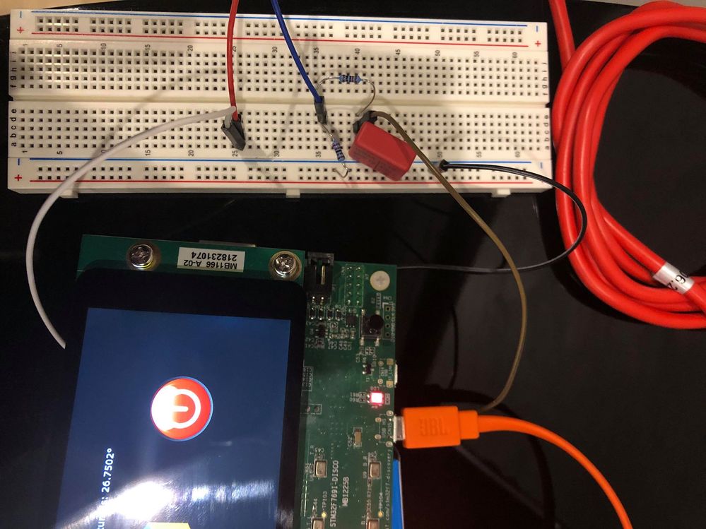

2019-03-19 12:28 PM
1. White wire is Vref (3.3V)
2 Red wire is one end of thermistor (connected to white wire)
3 Blue wire is other end of thermistor
4 Resistor going to ground is 2k2Ohm (connected to blue)
5 Resistor going to brown is 10kOhm (connected to blue)
6 Brown wire is going to ADC
7 Capacitor is 150nF ceramic going to ground as well (connected to brown)
8 Black wire is connected to ground pin
