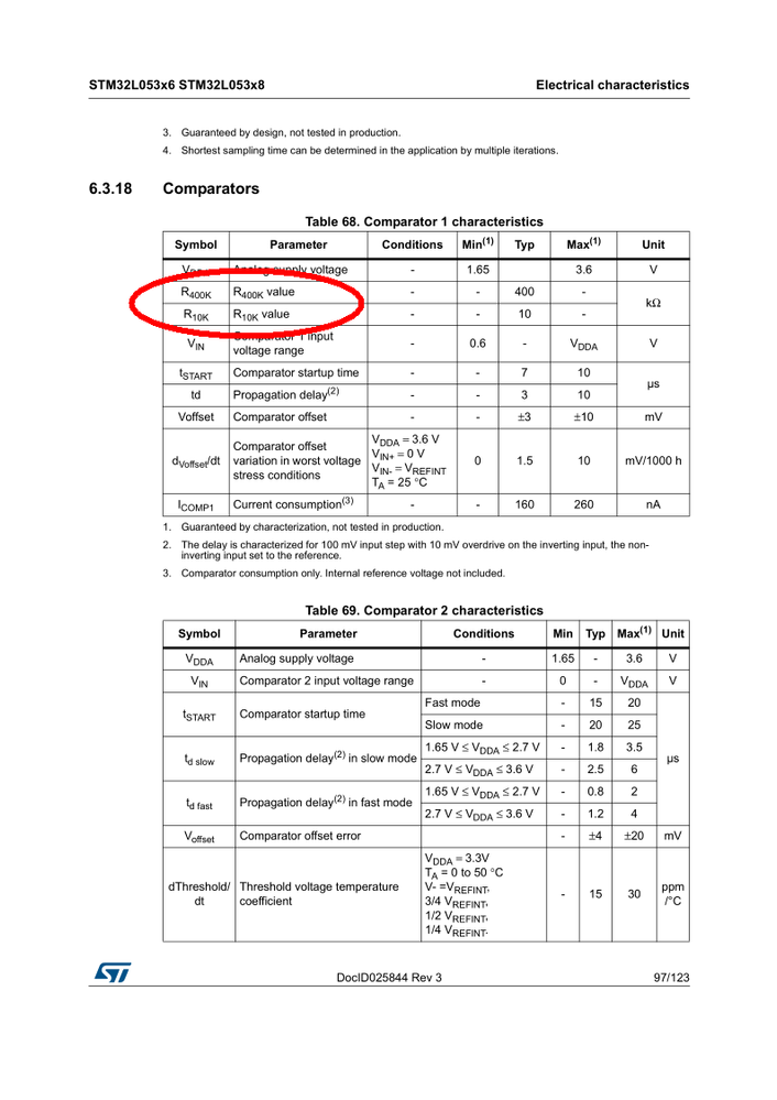

2018-11-30 3:01 PM
I see it also in other 'L0xx datasheets, yet no mention of it in the respective RM.

Hello @Community member ,
Thank you for bringing this to our attention.
I will check this internally and come back to you.
Kind Regards,
Imen
2018-12-04 7:27 AM
Hi @Community member ,
Those data R400k and R10k should not appear in STM32L0 datasheets !
I raised internally a request to update and remove those data from the STM32L0 datasheets.
Thanks for your contribution.
Kind Regards,
Imen

2018-12-04 1:21 PM
and the details slip back into the darkness....
Suppose it's calibration for ADC or COMP
2018-12-04 1:39 PM
Clive,
in the 'L1 RM, there are switchable pulldowns/pullups on the comparator input. My guess is that this was a purpose-designed feature for a key customer. I wouldn't be surprised if this was intended to measure capacitance, for whatever reason. And, again a guess, to spare area, the resistors were kicked out when the COMP cell was migrated to 'L0; the values got into the datasheet through copy-paste.

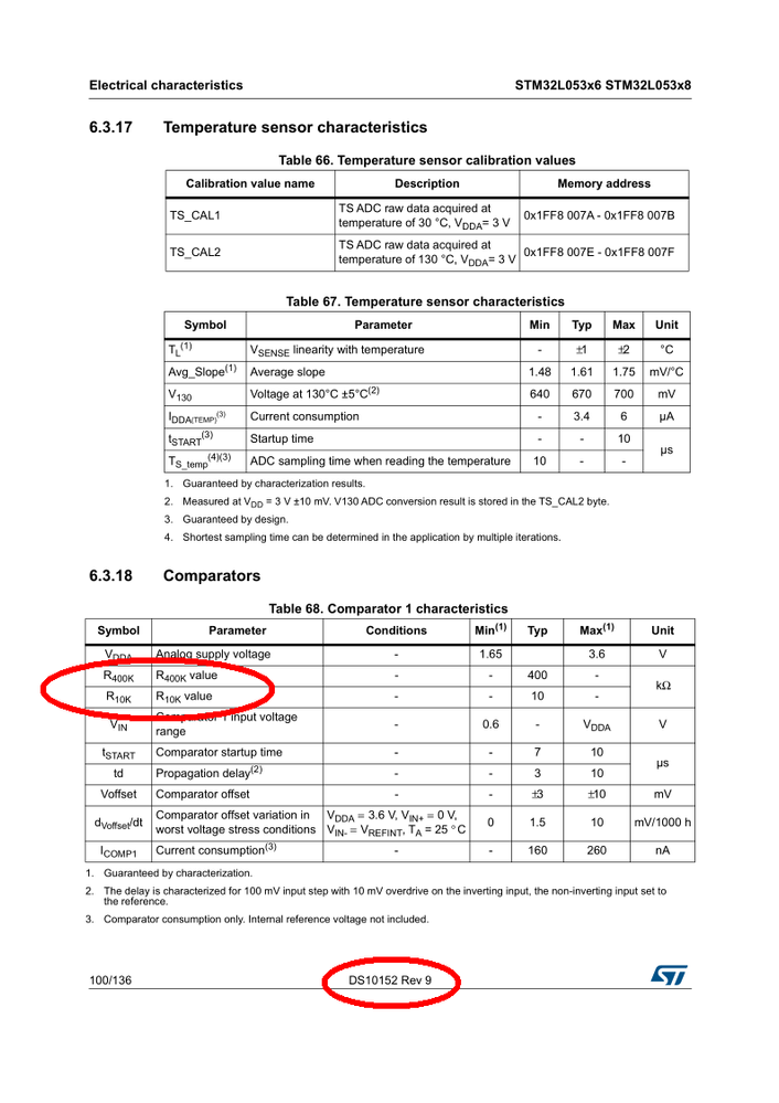

2019-10-18 2:55 AM
Hi @Imen DAHMEN ,
so, how exactly does this "internal request to update" work?
The following DS is dated 27.Jun 2019, whereas we've discussed this in December 2018.
Jan
2019-10-18 5:27 AM
Hello Jan,
Unfortunately, this is was missed to update in the new Datasheet as the request concerned all STM32L0 datasheets.
I will re-submit a new request and will push to correct this.
Thank you for your feedback and understanding.
Best Regards,
Imen
2019-10-18 5:29 AM
Thanks, Imen.
Jan
2019-10-18 7:57 AM
Next STM32L051 datasheet updated in few days will integrate the correction.
