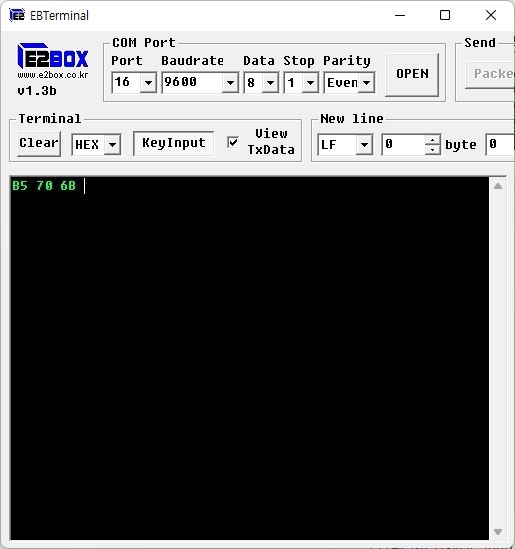

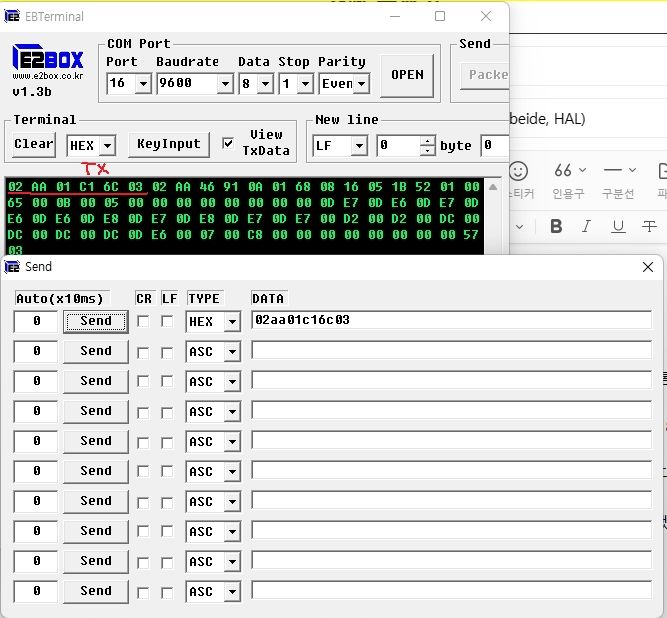

I tested using 485 to USB module then, when I check the terminal, it seems like ok for communicating. actually i got the data what i want
(i attatched jpg file)

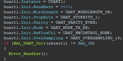

the problem is that using the HAL library and setting 9600 8-E-1 for blue pill, such like attached jpg
Tx data seems like weird. Result is here

2023-02-03 12:34 AM
Config in 9 bit mode to accommodate the parity bit.
ST includes it in the data payload, ie 8+1
