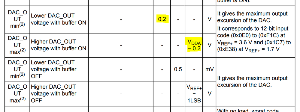

The output of the DAC with the output buffer enabled is not rail to rail.

Is it nucleo? There is a led to blame. Change for another dac or desolder jumper
