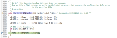

Example: I hit a breakpoint in the interrupt handler in stm32h5xx_hal_i3c.c.

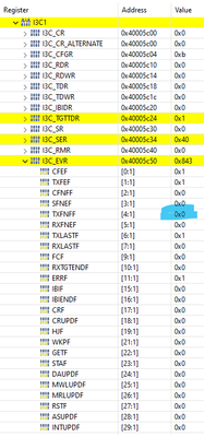

The event register does not show the TXFNFF:

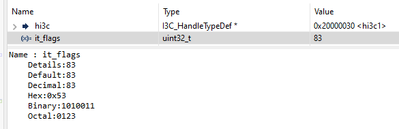

But the ISR code has obviously seen it because the event register was read in line 1618 (first screenshot above) and stored in it_flags where bit 4 is now set:

ST customer support has solved this issue in an internal case (all credit goes to Radek!). The explanation is as follows:
In I3C_EVR, bit 11 (ERRF) is set (as seen in the screenshot above):
Looking at I3C_SER, bit 6 (DOVR) is set (as seen in the screenshot above):
So because of the breakpoint, the Tx FIFO was not filled in time and suffered from an under-run which resulted in the error state where the flag was cleared.
The peripherals are not stopped when the CPU is stopped by the debugger.
