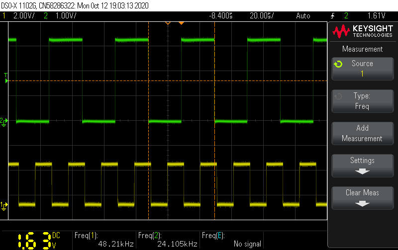

I tried this exact configuration, the MCLK, FWS, and SCLK are all correct, however when I see the sampling frequency its double of the FW?
The green signal is the On and Off when the DMA triggers. Sample buffer is length of 4
so it will trigger at 2 and 4. High is Complete and Low is Half Complete
Yellow signal is the FWS

}The math to find out the F_sample (Green Signal)
Half Complete triggers every 20.6uS for every 2 Samples.
Thus in 1 second 97kSamples are obtained, which is close to 96kSamples and not 48kSamples as it was suggested from the reference manual
UPDATE 1:
I have tried making FWS = 96kHz this caused the sampling frequency to be closed to 192khz so it looks like the sampling frequency for I2S is FWS*2?

I2S is inherently stereo, so you have 2 data per sample.
2020-10-13 10:17 AM
Ahhh, I was under the assumption since I made changes to the "FTHLV" register to be 1 data. So It would only transfer the Left side audio
2020-10-21 10:47 AM
I don't use the 'H7 and the SPI/I2S module there is a beast, but, AFAIK, FTHLV impacts only the "inward" SPI/I2S-to-processor interface, not the "outward" behaviour of the "protocol interface".
