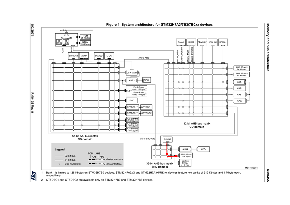

OK so you've narrowed down the problem to being probably DMA-related.
One of the common reasons why DMA on 'H7 does not work is, that buffer is located in inappropriate type of SRAM, where the given DMA has no access. In your case, if you use BDMA2, only the "SRD" SRAM can be used, you have to locate your buffer there.
(btw. I don't understand why ST had the urge to rename the various clock/matrix domains in the 'H7B3 so that they don't match nomenclature of other 'H7, adding to confusion... but that's ST documentation crew for you.)
There may be other reasons, too. Read https://community.st.com/s/article/FAQ-DMA-is-not-working-on-STM32H7-devices .

2022-07-16 2:47 AM
