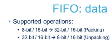

You dont want to try, what i recommended , so maybe good, you read about the DMA first :
https://www.st.com/resource/en/product_training/STM32F7_System_DMA.pdf
+ especially this:
And about audio processing:
https://www.eetimes.com/fundamentals-of-embedded-audio-part-3/
