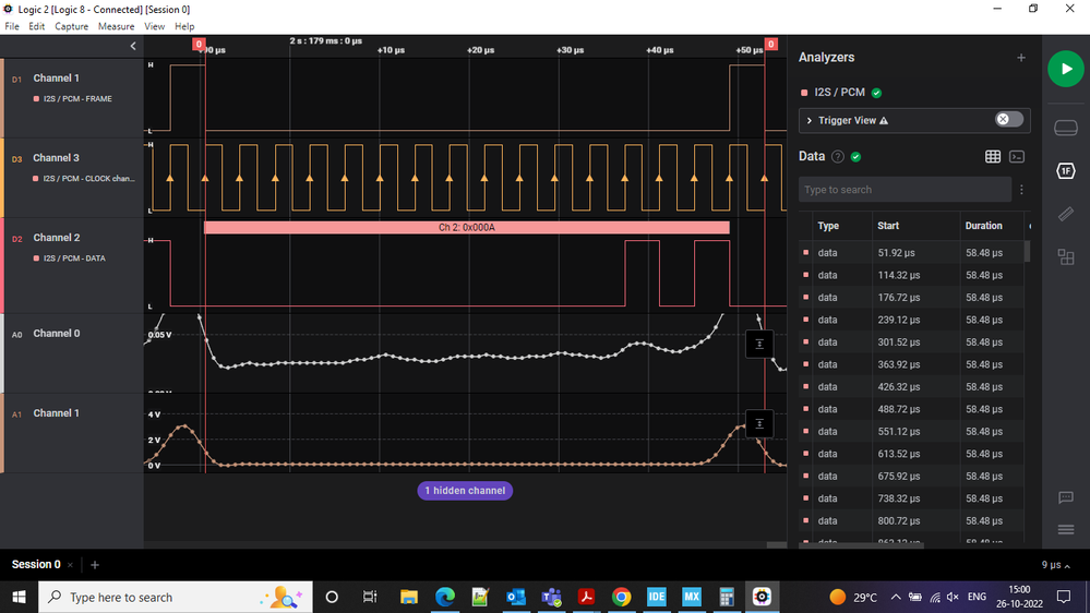

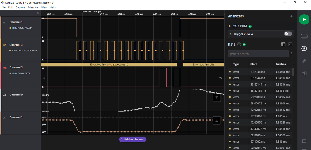

This is what I am receiving on the logic analyzer and could not relate it to waveform of the stm32f746 reference manual and I am not understanding how WS is behaving

Hello there was error in the setting of the logic analyzer attaching the new screenshot where I am getting exactly what I am sending
2022-10-26 3:48 AM
So, you don't see any data doubling in the signal? Then the problem can be localized to the receiver.

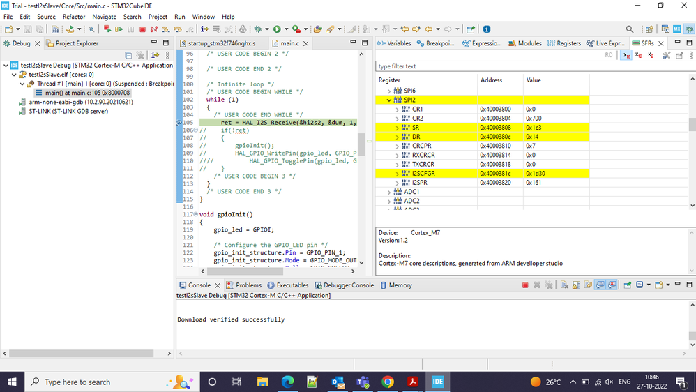

Do you use DMA? Read out and check/post content of SPI/I2S and DMA registers content.

stm32f746 discovery board as my receiver.
No I am not using DMA its just polling method.
2022-10-27 12:08 AM
I think you may check status registers of I2S for issue analysis, like OVR, UDR...
