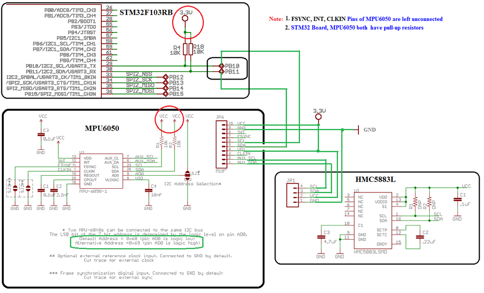

I have STM32-P103 board which uses STM32F103RB micro. I connected an I2C sensor to I2C2 pins. STM32-P103 board, MPU6050 sensor breakout board schematics are below :

Is it this problem ?
2012-05-18 3:16 AM
@fm
http://www.keil.com/forum/18440/
I checked that thread before posting here.I2Cx-> OAR1 = (I2C_InitStruct-> I2C_AcknowledgedAddress | I2C_InitStruct-> I2C_OwnAddress1); when this line excuted,
I2Cx-> OAR1 =0x4068 = 0x4000 | 0x0068
Seems it is not a problem. The optimized I2C sample also has the same line inside the function: I2C_Init(I2C_TypeDef * I2Cx, I2C_InitTypeDef * I2C_InitStruct)
My first post is edited with clear connection diagram. I doubt pull-up resistors. STM32 board as well as MPU6050 sensor board has pull-up resistors. will it be a problem ? Thank you2012-05-18 3:41 AM
in your schematics, there are 10k PU on both side. This makes effectively 5K PU. This should not be a problem
