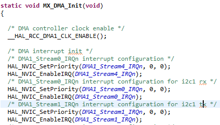

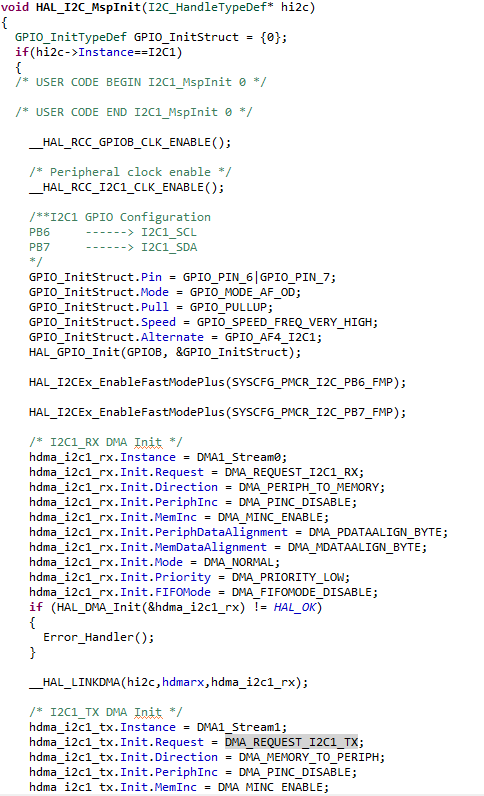

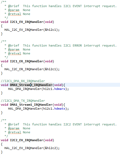

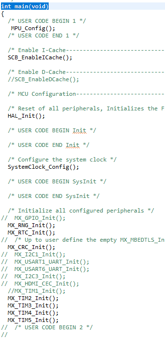

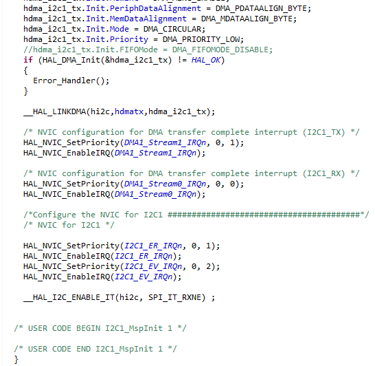

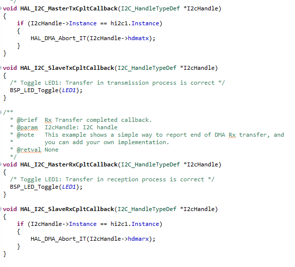

the attached picture with:
1) i2c1_rx_buffer and i2c1_tx_buffer declarations:
2) flash ld file code with the buffers sections
3) MX_DMA_Init()
4) HAL_I2C_MspInit() of I2C1:
5) i2c interrupts:
6) start of my main::
7) i2c call back functions:

Stuck reentering interrupt handler? Check pending status have been cleared, or which ones aren't.
2021-12-07 6:32 AM
Why is MX_I2C1_Init commented out?
2021-12-08 12:04 AM
It's not really a commented out - it's called later in the main function, I just forgot to delete this line from the print screen attached
2021-12-08 6:45 AM
It's not called anywhere in the code you provided.
Consider attaching the source code file rather than providing screenshots of code which don't even tell the whole story.

since I've developed only in ComPolling mode so far and everting worked perfectly I would like to learn and under stand the following:
In DMA mode, what is the correlation between I2C1_EV_IRQHandler() interrupt handler and my DMA1_Stream0_IRQHandler() interrupt handler ?
(in case that DMA1_Stream0 is the chosen one for I2C1 block Instance in the i2c1_rx dma init)
do i need to enable them both using HAL_NVIC_SetPriority and HAL_NVIC_EnableIRQ im my HAL_I2C_MspInit()?

I'm guessing based on this and based on your description that you've provided the code for the slave, not the master. It sounds like the issue is on the slave side, so that's good.
HAL_I2C_Slave_Receive_DMA(hi2c, buffer, size);
//HAL_I2C_Master_Transmit_DMA(hi2c, uint16_t DevAddress, uint8_t *pData, uint16_t Size);Your code doesn't actually call these functions though, as the calls to the functions they're in are commented out:
// RingBufferDmaU8_initI2cRx(&i2cRxRing, &hi2c1, i2c1_RxBuffer, I2C1_RX_BUFFER_SIZE);
// RingBufferDmaU8_initI2cTx(&i2cTxRing, &hi2c1, i2c1_TxBuffer, I2C1_TX_BUFFER_SIZE);Setting the address like this doesn't change anything (assuming it's not commented out). The address must be set when HAL_I2C_Init is called.
// hi2c1.Init.OwnAddress1 = (I2C1_ADDRESS_1 << 1);
// hi2c1.Init.OwnAddress2 = (I2C2_ADDRESS_2 << 1);You have the slave address as 0 when they're initialized: 0 is a special address, which shouldn't be used as a specific slave address. Unsure if this is the source of the issue.
hi2c1.Instance = I2C1;
hi2c1.Init.Timing = 0x10103AFF;
hi2c1.Init.OwnAddress1 = 0;
hi2c1.Init.AddressingMode = I2C_ADDRESSINGMODE_7BIT;
hi2c1.Init.DualAddressMode = I2C_DUALADDRESS_DISABLE;
hi2c1.Init.OwnAddress2 = 0;
hi2c1.Init.OwnAddress2Masks = I2C_OA2_NOMASK;
hi2c1.Init.GeneralCallMode = I2C_GENERALCALL_DISABLE;
hi2c1.Init.NoStretchMode = I2C_NOSTRETCH_DISABLE;I would recommend making the program much simpler in order to debug, using CubeMX generated code where possible. Try to get HAL_I2C_IsDeviceReady to return HAL_OK on the master side first, then move on to sending/receiving in blocking mode, then move on to DMA mode.
I realize you've been debugging the problem with this code and it has changed over time. However, it makes it very difficult to debug when I have to guess at which lines should be uncommented and which should not.
