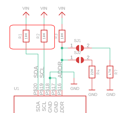

@sadeepTA wrote:2. I am not using any external pullups. Am I supposed to use it like that?
Pullups are fundamental to the operation of I2C.
@sadeepTA wrote:My sensor is an Adafruit MCP 9600
The MCP9600 is a Microchip product: https://www.microchip.com/en-us/product/mcp9600
I presume you mean this Adafruit "breakout board" - which features the Microchip MCP9600:
https://learn.adafruit.com/adafruit-mcp9600-i2c-thermocouple-amplifier
So the question becomes: does that board provide the required pullups?
The schematics are here:
https://learn.adafruit.com/adafruit-mcp9600-i2c-thermocouple-amplifier/downloads
and show that pullups are, indeed, provided on the board:
#Pullups #I2CPullups
