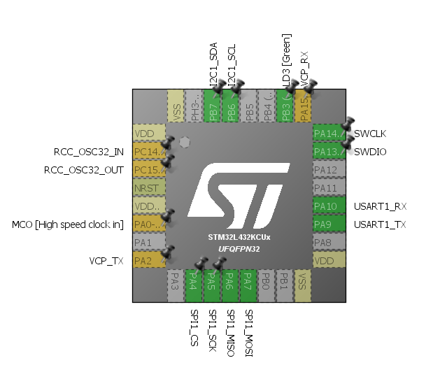

The device isthe STM32 Nucleo for L4 series (STM32L432KCU6). I'm using STM32CubeMX and System Workbench for Stm
I also attach the pin configuration:

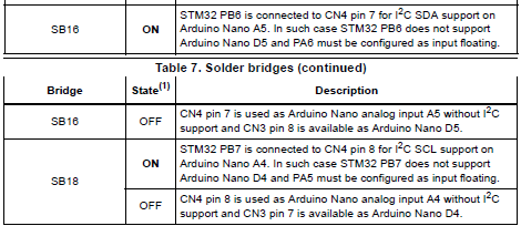

I think that it could be something related to the configuration of solder bridges SB16 and SB18. In their default state (on) they do not allow using PA5 and PA6 on their assigned pins (CN4 7 and 8) but they connect the pins directly to PB6 and PB7.
I think that's why, in the original pin configuration, what happened on SPI pins influenced I2C communication: because the pins where connected each other.

I disabled USART1 and used PA9/10 for I2C, now the problem isn't there anymore.
