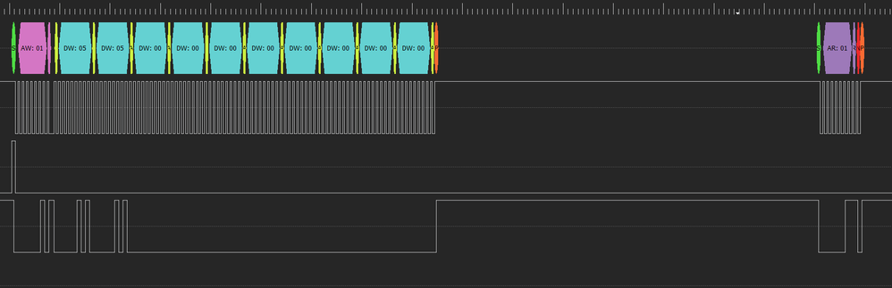

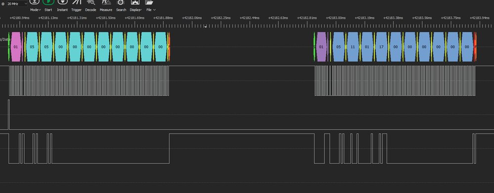

This is what i see at the logic analyzer.
Pictures goes from all good -> moment of terror -> continuously terror
What can cause HAL I2C to stop working like this?
How can i do a full reset of HAL I2C ?
Does anyone have a link to non HAL I2C code, or should i write myself? already spend too much time on this issue....
