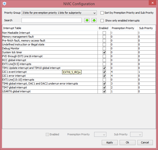

I'm trying to do a blocking I2C read in another interrupt. If I receive a NAK the HAL seems to crash (I'm seeinguwTick
stop). Both the I2C interrupt and the interrupt I'm doing the read from have a lower (higher numerically) priority than the system tick timer. Does anyone know why this could be happening?We’re moving the ST Community to a new platform to give you a better and more reliable community experience.
