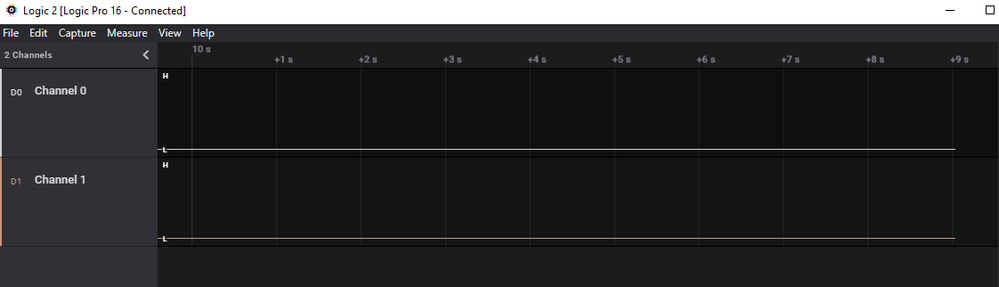

Hello i am trying to use I2C interrupt communication between my STM32L4 and an NFC module, however when i try to visualize the signal i have nthg. I feel like i have forgotten sth, but i can't figure out what is it. Can you please help?
This is what i currently have:

}the signal visualization:
2022-01-05 7:20 AM
Nothing obviously incorrect that would cause this issue in the code you presented. Are you actually calling these functions in the code? Are pins initialized? What is the return status from HAL_I2C_Master_Transmit_IT?
Verify you're monitoring the right pins and the hardware connection exists by initializing them as GPIO outputs and toggling.
Edit: Your buffer in comI2C_NFC_TxBuffer must remain in scope. It can't be stack-based variable, it needs to be global or otherwise remain valid until completion. However, this would not cause the issue.
