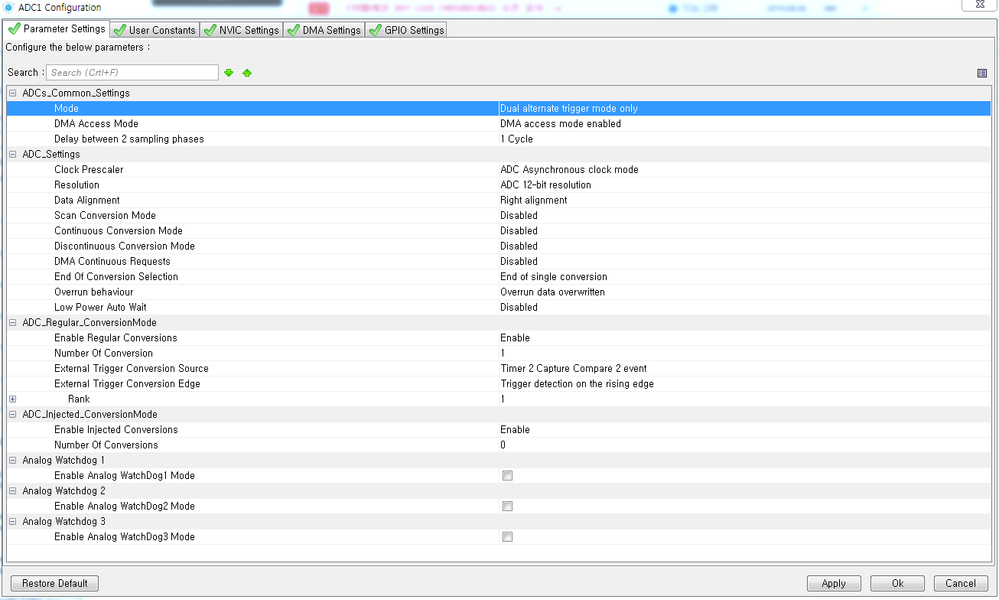

I want to convert 4 analog input in the same time, I chose the stm32f3 303vdt because it contains 4 ADCs. The problems is that I don't know how to get them working together. I have read that only two of them can work simultaneously ADC1 and ADC2, ADC3 and ADC4.
so i can use DMA setting.
My question is what's configuration have I to do for this stuff?

how can i dual adc mode?
2017-03-30 11:14 PM
Use them in pairs (ADC1+ADC2, ADC3+ADC4) in dual mode, then use a common external trigger (TIM) to synchronize them. I believe posted an example of doing this to the forum.
