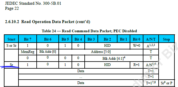

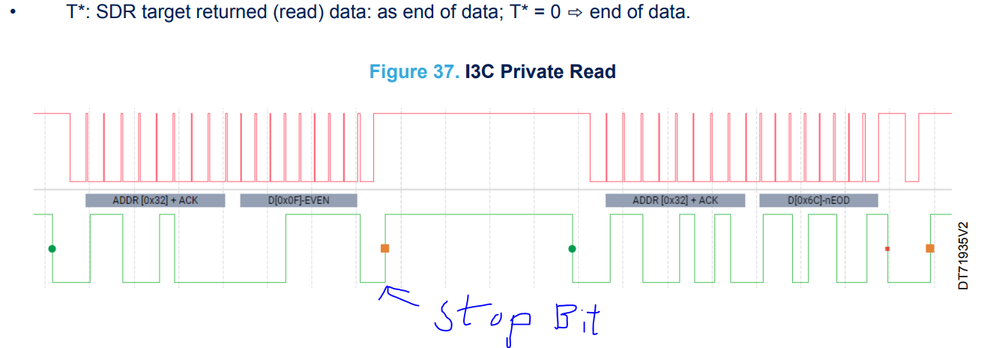

1. CCC SetAASA is OK , When I read register address 0x1 with I3C 1byte private read , I3C read value is not what i want . Read value is pointing register address 0x0 value and fixed . I think there is a stop bit in Read protocol and after Stop bit , Internal read pointer in my chip is cleared
example an5879, 9.8 Private Read code , also Stop Bit in I3C private Read command
* It is JEDEC I3C Specification , repeated start bit , No Stop Bit in Read Command

2. I tried to change it when TX frame setting , but Not cleared
I3C_PRIVATE_WITH_ARB_STOP ==> I3C_PRIVATE_WITH_ARB_RESTART , MEND=0
Can u tell me how to do it ?
