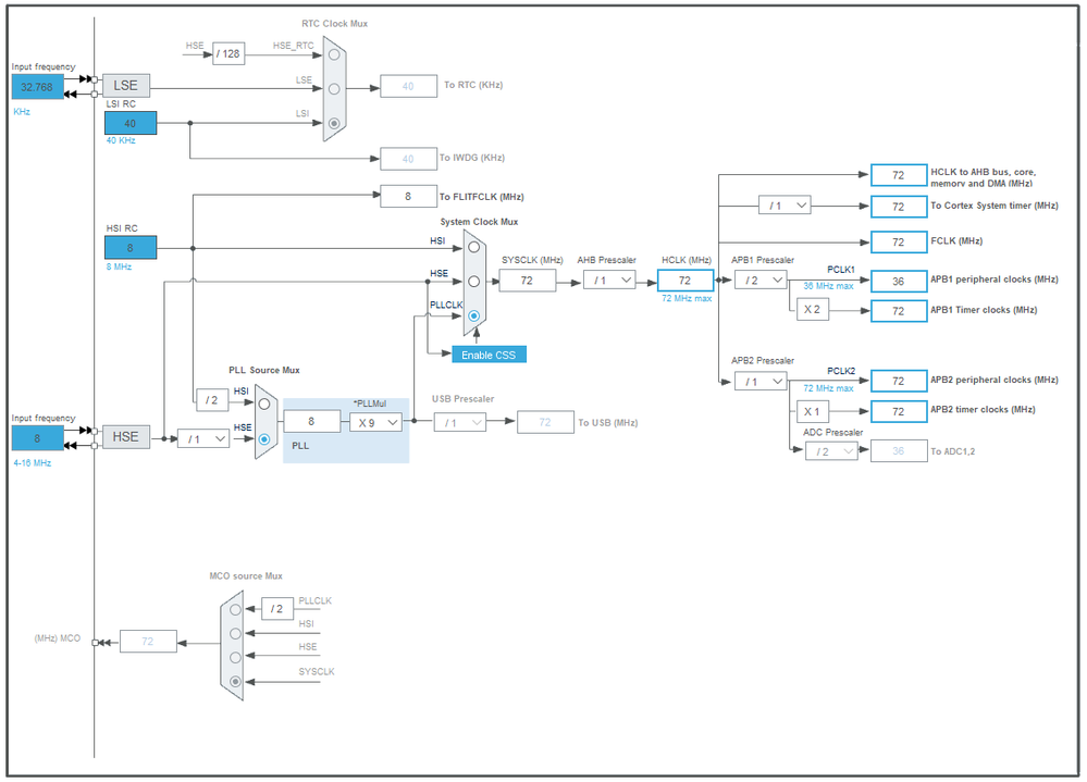

2021-06-26 6:47 AM
Try doing this with a simple free-running TIM clocking at 1 MHz, 16-bit maximal mode
SysTick counts DOWN
Review what actual code is executing with the RCC/PLL settings.
Output the internal clock via MCO (PA8) and scope that.
2021-06-26 6:49 AM
For sub-microsecond granularity look at DWT CYCCNT, 32-bit up-count at core frequency
SysTick can clock at SYSCLK(HCLK,) or the SYSCLK DIV8, 24-bit down-count
