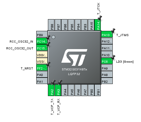

why this mismatch in this or did i get confused? please help me with this. i want to connect user led port to external led

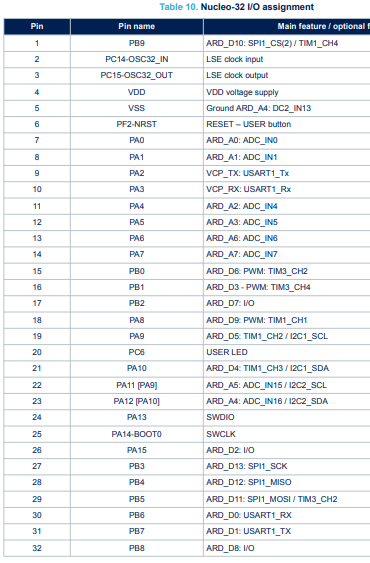

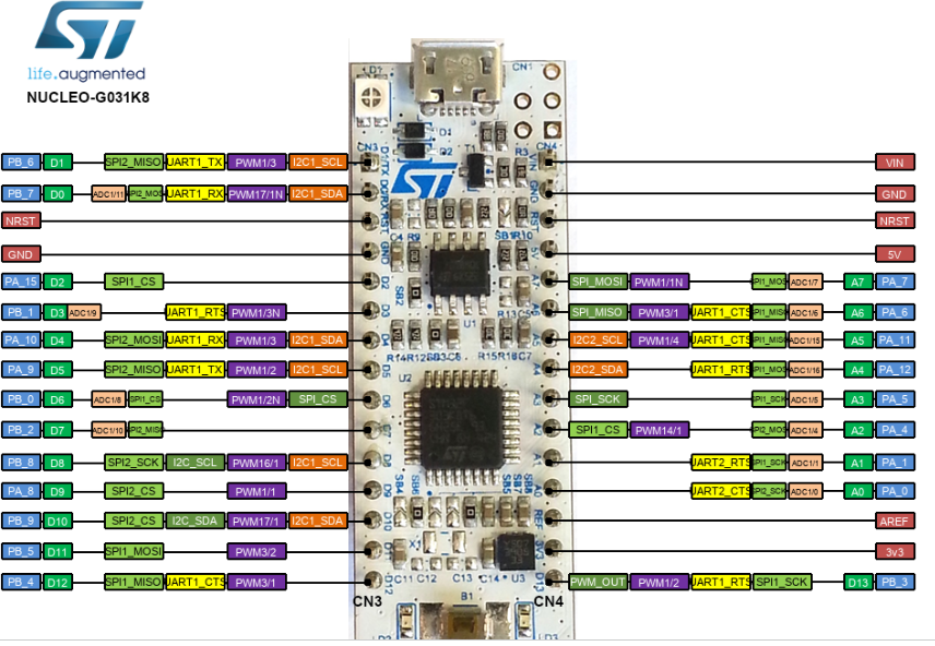

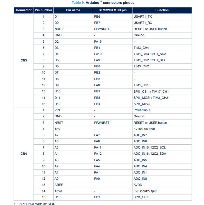

Your pins avaiable on your stm32g0 directly through goldpins are in following tables:

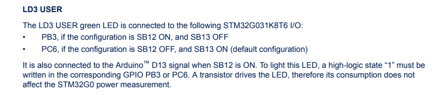

If you want connect user led with external led you must change soldier brigdes:
and them connect your external led to PB3
