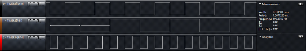

i try to Synchronization two timer together in master / slave mode
i have a problem when i enable another timer interrupt ,once of two sync timer freq was changed!!
you can see in my logic analyzer result

and use another timer 14 for free running with interrupt
when i enable timer14 intteerupt ,timer 3 freq changed!!
this result when timer14 interrupt is disable:

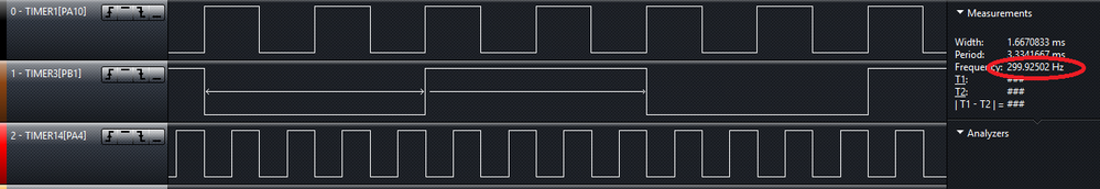

and this picture is when timer14 interrupt is enable:
you can see when interrupt enable for timer 14, freq timer 3 changed!!!
why this happened?

2020-01-11 4:13 PM
i want use timer 14 as free running timer with interrupt , and timer 1 & 3 in sync master slave mode
when i disable timer 14 interrupt, timer 1,3 work fine as master slave mode
but when i enable timer 14 interrupt you can see timer 3 frequency changed!
and i don't know why this happend
