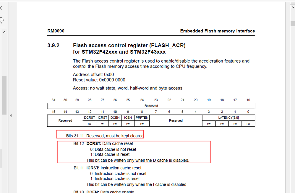

there is maybe a mistake at the page 99 in the RM0090 Reference manual document:
the bit area 12 is valid or not?

Bits 31:13 should be marked as reserved, instead of 31:11.
It is correct in 3.9.1 but incorrect in 3.9.2.

Hello @fang liang ,
Can you please describe clearly the issue with bit 12 ?
Why is that not valid ?

I guess it's because the range 31:11 is declared Reserved, but just below you have bit 12 and 11 shown as readable and/or writable.
bits 12 and 11 are in the range 31:11.
2021-11-23 3:19 AM
Should the reserved bits be 31:13 or should bits 12 and 11 be reserved?

The reserved bits should be Bits 31:13, as answered @TDK.
The typo is raised internally for correction in the coming release of the RM0090.
Thanks for your contribution.

Also the PM0059 has exactly the same error.
