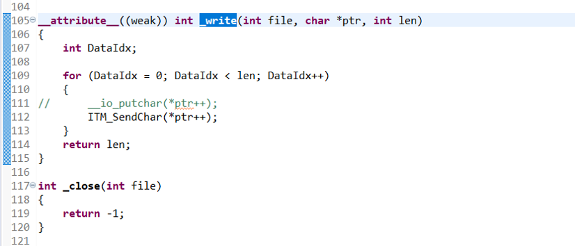

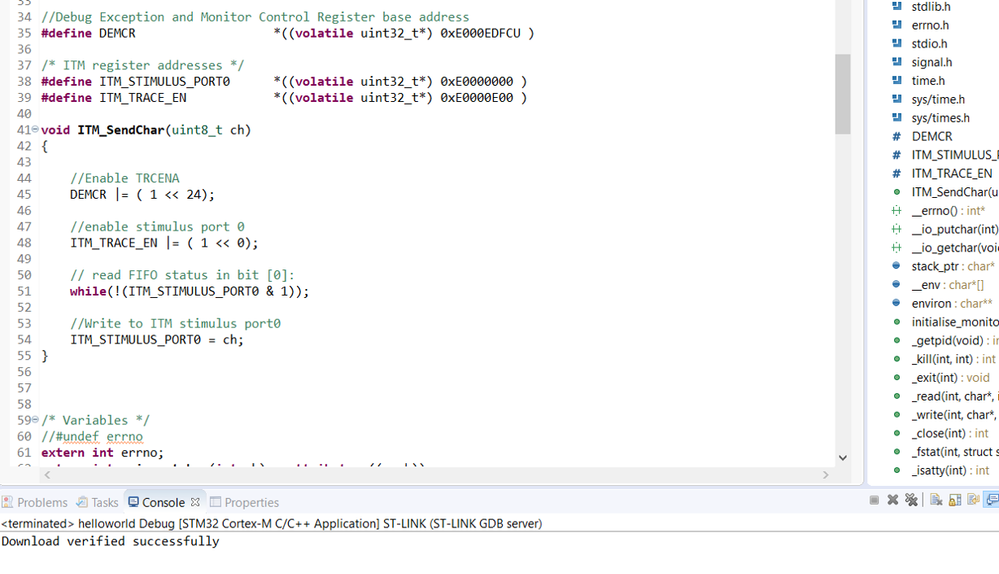

The steps that I had done (STM32F429I-DISC1 Board)
1. copy and paste the code into syscalls.c
2. edit the _write function

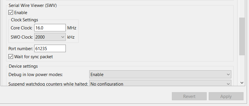

4. build the project
5. edit the debugger setting

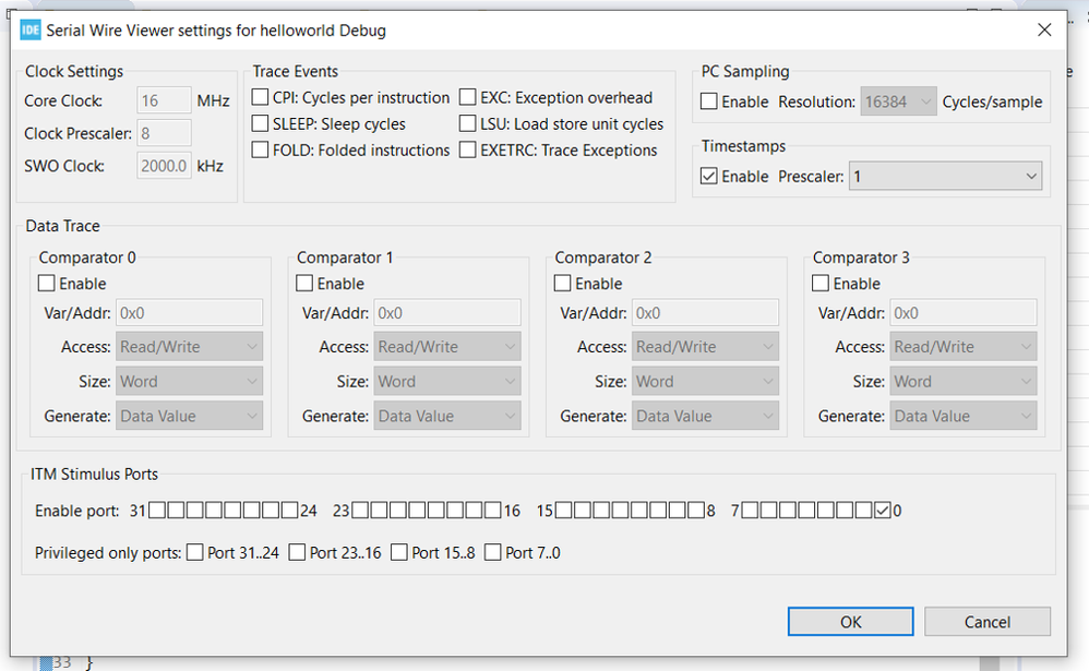

6. start debug
7. enable the SWV ITM Data Console

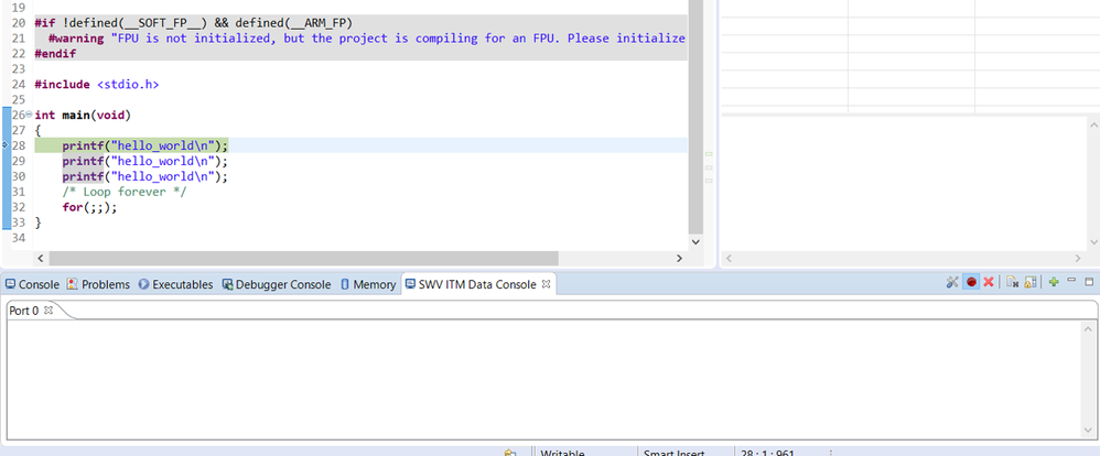

8. enable the port 0 in SWV
9. the screen before press resume
10: Nothing come out... can you please help me?

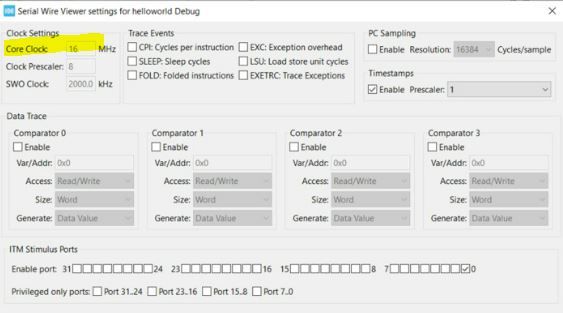

Are you really running the core at 16 MHz, and not 168 MHz or 180 MHz?

Check you Clock configuration (SYSCLK, HSE_VALUE)
Make sure to connect the SWV pin for Trace functionality and follow this AN4989, which will help you on printf debugging.
