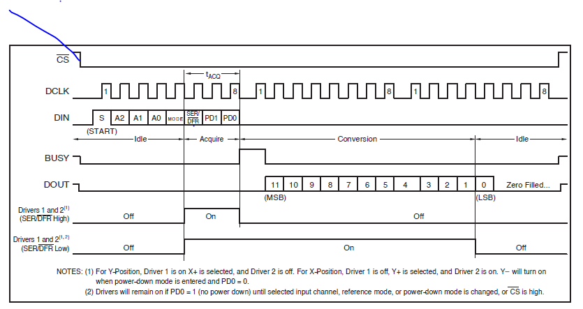

2022-03-29 9:50 PM
in above image after transmitting data, DIN pin is low but in my case idle condition is low but after data transmission its show high

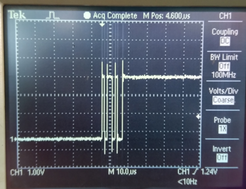

2022-03-29 10:07 PM
2022-04-11 11:41 PM
sir i am using HAL library its successfully work but when i trying without HAL library its not work. i was already share you the details , MOSI pin waveform & code flow.
