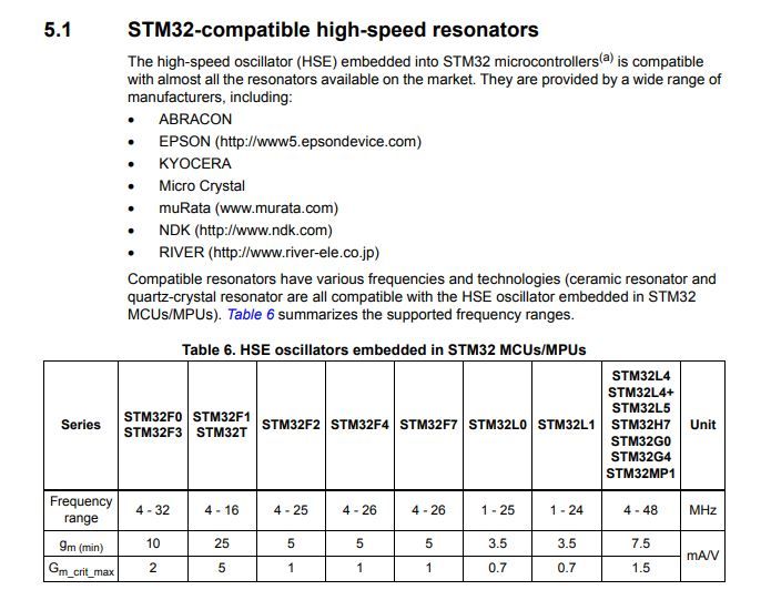

Make sure to use a HSE which is listed in AN2867 as compatible with STM32H7 series.
