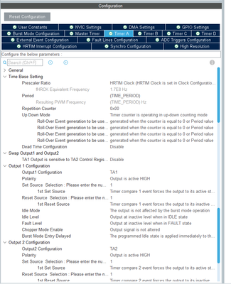

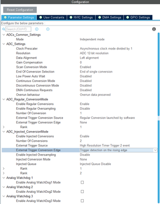

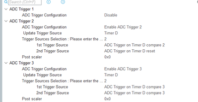

I am using hrtim to trigger the adc, but if the regular channel is not triggered with hrtim, it doesn't go into the interrupt of the ADC properly, I checked a lot of information and didn't find a solution, here is my code and cubemx configuration:

  LL_HRTIM_ConfigADCTrig(HRTIM1, LL_HRTIM_ADCTRIG_2, LL_HRTIM_ADCTRIG_UPDATE_TIMER_D, LL_HRTIM_ADCTRIG_SRC24_TIMDCMP2|LL_HRTIM_ADCTRIG_SRC24_TIMDRST);
  LL_HRTIM_SetADCPostScaler(HRTIM1, LL_HRTIM_ADCTRIG_2, 0x0);
  LL_HRTIM_ConfigADCTrig(HRTIM1, LL_HRTIM_ADCTRIG_3, LL_HRTIM_ADCTRIG_UPDATE_TIMER_D, LL_HRTIM_ADCTRIG_SRC13_TIMDCMP3|LL_HRTIM_ADCTRIG_SRC13_TIMDCMP3);
  LL_HRTIM_SetADCPostScaler(HRTIM1, LL_HRTIM_ADCTRIG_3, 0x0);

  LL_HRTIM_TIM_SetPrescaler(HRTIM1, LL_HRTIM_TIMER_A, LL_HRTIM_PRESCALERRATIO_DIV1);
  LL_HRTIM_TIM_SetCounterMode(HRTIM1, LL_HRTIM_TIMER_A, LL_HRTIM_MODE_CONTINUOUS);
  LL_HRTIM_TIM_SetPeriod(HRTIM1, LL_HRTIM_TIMER_A, (TIME_PERIOD));
  LL_HRTIM_TIM_SetRepetition(HRTIM1, LL_HRTIM_TIMER_A, 0x00);
  LL_HRTIM_TIM_SetUpdateGating(HRTIM1, LL_HRTIM_TIMER_A, LL_HRTIM_UPDATEGATING_INDEPENDENT);
  LL_HRTIM_TIM_SetCountingMode(HRTIM1, LL_HRTIM_TIMER_A, LL_HRTIM_COUNTING_MODE_UP_DOWN);
  LL_HRTIM_TIM_SetTriggeredHalfMode(HRTIM1, LL_HRTIM_TIMER_A, LL_HRTIM_TRIGHALF_DISABLED);
  LL_HRTIM_TIM_SetComp1Mode(HRTIM1, LL_HRTIM_TIMER_A, LL_HRTIM_GTCMP1_EQUAL);
  LL_HRTIM_TIM_SetRollOverMode(HRTIM1, LL_HRTIM_TIMER_A, LL_HRTIM_ROLLOVER_MODE_BOTH);
  LL_HRTIM_TIM_SetFaultEventRollOverMode(HRTIM1, LL_HRTIM_TIMER_A, LL_HRTIM_ROLLOVER_MODE_BOTH);
  LL_HRTIM_TIM_SetBMRollOverMode(HRTIM1, LL_HRTIM_TIMER_A, LL_HRTIM_ROLLOVER_MODE_BOTH);
  LL_HRTIM_TIM_SetADCRollOverMode(HRTIM1, LL_HRTIM_TIMER_A, LL_HRTIM_ROLLOVER_MODE_BOTH);
  LL_HRTIM_TIM_SetOutputRollOverMode(HRTIM1, LL_HRTIM_TIMER_A, LL_HRTIM_ROLLOVER_MODE_BOTH);
  LL_HRTIM_TIM_SetDACTrig(HRTIM1, LL_HRTIM_TIMER_A, LL_HRTIM_DACTRIG_NONE);
  LL_HRTIM_TIM_DisableHalfMode(HRTIM1, LL_HRTIM_TIMER_A);
  LL_HRTIM_TIM_SetInterleavedMode(HRTIM1, LL_HRTIM_TIMER_A, LL_HRTIM_INTERLEAVED_MODE_DISABLED);
  LL_HRTIM_TIM_DisableStartOnSync(HRTIM1, LL_HRTIM_TIMER_A);
  LL_HRTIM_TIM_DisableResetOnSync(HRTIM1, LL_HRTIM_TIMER_A);
  LL_HRTIM_TIM_EnablePreload(HRTIM1, LL_HRTIM_TIMER_A);
  LL_HRTIM_TIM_SetUpdateTrig(HRTIM1, LL_HRTIM_TIMER_A, LL_HRTIM_UPDATETRIG_NONE|LL_HRTIM_UPDATETRIG_REPETITION|LL_HRTIM_UPDATETRIG_RESET);
  LL_HRTIM_TIM_SetResetTrig(HRTIM1, LL_HRTIM_TIMER_A, LL_HRTIM_RESETTRIG_NONE);
  LL_HRTIM_TIM_DisablePushPullMode(HRTIM1, LL_HRTIM_TIMER_A);
  LL_HRTIM_TIM_DisableDeadTime(HRTIM1, LL_HRTIM_TIMER_A);
  LL_HRTIM_TIM_EnableFault(HRTIM1, LL_HRTIM_TIMER_A, LL_HRTIM_FAULT_2);
  LL_HRTIM_TIM_SetBurstModeOption(HRTIM1, LL_HRTIM_TIMER_A, LL_HRTIM_BURSTMODE_MAINTAINCLOCK);
  LL_HRTIM_ForceUpdate(HRTIM1, LL_HRTIM_TIMER_A);
  LL_HRTIM_TIM_DisableResyncUpdate(HRTIM1, LL_HRTIM_TIMER_A);
  LL_HRTIM_TIM_SetCompare1(HRTIM1, LL_HRTIM_TIMER_A, (Duty_cycle));
  LL_HRTIM_TIM_SetCompareMode(HRTIM1, LL_HRTIM_TIMER_A, LL_HRTIM_COMPAREUNIT_2, LL_HRTIM_COMPAREMODE_REGULAR);
  LL_HRTIM_TIM_SetCompare2(HRTIM1, LL_HRTIM_TIMER_A, (Duty_cycle));
  LL_HRTIM_OUT_SetPolarity(HRTIM1, LL_HRTIM_OUTPUT_TA1, LL_HRTIM_OUT_POSITIVE_POLARITY);
  LL_HRTIM_OUT_SetOutputSetSrc(HRTIM1, LL_HRTIM_OUTPUT_TA1, LL_HRTIM_OUTPUTSET_TIMCMP1);
  LL_HRTIM_OUT_SetOutputResetSrc(HRTIM1, LL_HRTIM_OUTPUT_TA1, LL_HRTIM_OUTPUTRESET_TIMCMP1);
  LL_HRTIM_OUT_SetIdleMode(HRTIM1, LL_HRTIM_OUTPUT_TA1, LL_HRTIM_OUT_NO_IDLE);
  LL_HRTIM_OUT_SetIdleLevel(HRTIM1, LL_HRTIM_OUTPUT_TA1, LL_HRTIM_OUT_IDLELEVEL_INACTIVE);
  LL_HRTIM_OUT_SetFaultState(HRTIM1, LL_HRTIM_OUTPUT_TA1, LL_HRTIM_OUT_FAULTSTATE_INACTIVE);
  LL_HRTIM_OUT_SetChopperMode(HRTIM1, LL_HRTIM_OUTPUT_TA1, LL_HRTIM_OUT_CHOPPERMODE_DISABLED);
  LL_HRTIM_OUT_SetPolarity(HRTIM1, LL_HRTIM_OUTPUT_TA2, LL_HRTIM_OUT_POSITIVE_POLARITY);
  LL_HRTIM_OUT_SetOutputSetSrc(HRTIM1, LL_HRTIM_OUTPUT_TA2, LL_HRTIM_OUTPUTSET_TIMCMP2);
  LL_HRTIM_OUT_SetOutputResetSrc(HRTIM1, LL_HRTIM_OUTPUT_TA2, LL_HRTIM_OUTPUTRESET_TIMCMP2);
  LL_HRTIM_OUT_SetIdleMode(HRTIM1, LL_HRTIM_OUTPUT_TA2, LL_HRTIM_OUT_NO_IDLE);
  LL_HRTIM_OUT_SetIdleLevel(HRTIM1, LL_HRTIM_OUTPUT_TA2, LL_HRTIM_OUT_IDLELEVEL_INACTIVE);
  LL_HRTIM_OUT_SetFaultState(HRTIM1, LL_HRTIM_OUTPUT_TA2, LL_HRTIM_OUT_FAULTSTATE_INACTIVE);
  LL_HRTIM_OUT_SetChopperMode(HRTIM1, LL_HRTIM_OUTPUT_TA2, LL_HRTIM_OUT_CHOPPERMODE_DISABLED);

  LL_HRTIM_TIM_DisablePushPullMode(HRTIM1, LL_HRTIM_TIMER_C);
  LL_HRTIM_TIM_DisableDeadTime(HRTIM1, LL_HRTIM_TIMER_C);
  LL_HRTIM_TIM_SetBurstModeOption(HRTIM1, LL_HRTIM_TIMER_C, LL_HRTIM_BURSTMODE_MAINTAINCLOCK);
  LL_HRTIM_ForceUpdate(HRTIM1, LL_HRTIM_TIMER_C);
  LL_HRTIM_TIM_DisableResyncUpdate(HRTIM1, LL_HRTIM_TIMER_C);
  /* Poll for DLL end of calibration */
#if (USE_TIMEOUT == 1)
  uint32_t Timeout = 10; /* Timeout Initialization */
#endif  /*USE_TIMEOUT*/
  while(LL_HRTIM_IsActiveFlag_DLLRDY(HRTIM1) == RESET){
    if (LL_SYSTICK_IsActiveCounterFlag())  /* Check Systick counter flag to decrement the time-out value */
        if(Timeout-- == 0)
          Error_Handler();  /* error management */
#endif  /* USE_TIMEOUT */
  LL_HRTIM_TIM_SetPrescaler(HRTIM1, LL_HRTIM_TIMER_D, LL_HRTIM_PRESCALERRATIO_DIV1);
  LL_HRTIM_TIM_SetCounterMode(HRTIM1, LL_HRTIM_TIMER_D, LL_HRTIM_MODE_CONTINUOUS);
  LL_HRTIM_TIM_SetPeriod(HRTIM1, LL_HRTIM_TIMER_D, (TIMED_PERIOD));
  LL_HRTIM_TIM_SetRepetition(HRTIM1, LL_HRTIM_TIMER_D, 0x00);
  LL_HRTIM_TIM_SetUpdateGating(HRTIM1, LL_HRTIM_TIMER_D, LL_HRTIM_UPDATEGATING_INDEPENDENT);
  LL_HRTIM_TIM_SetCountingMode(HRTIM1, LL_HRTIM_TIMER_D, LL_HRTIM_COUNTING_MODE_UP_DOWN);
  LL_HRTIM_TIM_SetTriggeredHalfMode(HRTIM1, LL_HRTIM_TIMER_D, LL_HRTIM_TRIGHALF_DISABLED);
  LL_HRTIM_TIM_SetRollOverMode(HRTIM1, LL_HRTIM_TIMER_D, LL_HRTIM_ROLLOVER_MODE_BOTH);
  LL_HRTIM_TIM_SetFaultEventRollOverMode(HRTIM1, LL_HRTIM_TIMER_D, LL_HRTIM_ROLLOVER_MODE_BOTH);
  LL_HRTIM_TIM_SetBMRollOverMode(HRTIM1, LL_HRTIM_TIMER_D, LL_HRTIM_ROLLOVER_MODE_BOTH);
  LL_HRTIM_TIM_SetADCRollOverMode(HRTIM1, LL_HRTIM_TIMER_D, LL_HRTIM_ROLLOVER_MODE_BOTH);
  LL_HRTIM_TIM_SetOutputRollOverMode(HRTIM1, LL_HRTIM_TIMER_D, LL_HRTIM_ROLLOVER_MODE_BOTH);
  LL_HRTIM_TIM_SetDACTrig(HRTIM1, LL_HRTIM_TIMER_D, LL_HRTIM_DACTRIG_NONE);
  LL_HRTIM_TIM_DisableHalfMode(HRTIM1, LL_HRTIM_TIMER_D);
  LL_HRTIM_TIM_SetInterleavedMode(HRTIM1, LL_HRTIM_TIMER_D, LL_HRTIM_INTERLEAVED_MODE_DISABLED);
  LL_HRTIM_TIM_DisableStartOnSync(HRTIM1, LL_HRTIM_TIMER_D);
  LL_HRTIM_TIM_DisableResetOnSync(HRTIM1, LL_HRTIM_TIMER_D);
  LL_HRTIM_TIM_EnablePreload(HRTIM1, LL_HRTIM_TIMER_D);
  LL_HRTIM_TIM_SetUpdateTrig(HRTIM1, LL_HRTIM_TIMER_D, LL_HRTIM_UPDATETRIG_NONE|LL_HRTIM_UPDATETRIG_REPETITION|LL_HRTIM_UPDATETRIG_RESET);
  LL_HRTIM_TIM_SetResetTrig(HRTIM1, LL_HRTIM_TIMER_D, LL_HRTIM_RESETTRIG_NONE);
  LL_HRTIM_TIM_DisablePushPullMode(HRTIM1, LL_HRTIM_TIMER_D);
  LL_HRTIM_TIM_DisableDeadTime(HRTIM1, LL_HRTIM_TIMER_D);
  LL_HRTIM_TIM_SetBurstModeOption(HRTIM1, LL_HRTIM_TIMER_D, LL_HRTIM_BURSTMODE_MAINTAINCLOCK);
  LL_HRTIM_ForceUpdate(HRTIM1, LL_HRTIM_TIMER_D);
  LL_HRTIM_TIM_DisableResyncUpdate(HRTIM1, LL_HRTIM_TIMER_D);
  LL_HRTIM_TIM_SetCompareMode(HRTIM1, LL_HRTIM_TIMER_D, LL_HRTIM_COMPAREUNIT_2, LL_HRTIM_COMPAREMODE_REGULAR);
  LL_HRTIM_TIM_SetCompare2(HRTIM1, LL_HRTIM_TIMER_D, (Dduty_cycle));
  LL_HRTIM_TIM_SetCompare3(HRTIM1, LL_HRTIM_TIMER_D, (Dduty_cycle));
  /* USER CODE BEGIN HRTIM1_Init 2 */
	while(HAL_ADCEx_Calibration_Start(&hadc2,ADC_SINGLE_ENDED)!=HAL_OK);
	HAL_ADC_Start_IT(&hadc2);
	HAL_ADC_PollForConversion(&hadc2, 50);
	LL_HRTIM_EnableIT_FLT2(HRTIM1);
	LL_HRTIM_EnableIT_UPDATE(HRTIM1,LL_HRTIM_TIMER_C);

#include "adc.h"
/* USER CODE BEGIN 0 */
/* USER CODE END 0 */
ADC_HandleTypeDef hadc2;
  hadc2.Instance = ADC2;
  hadc2.Init.ClockPrescaler = ADC_CLOCK_ASYNC_DIV4;
  hadc2.Init.Resolution = ADC_RESOLUTION_12B;
  hadc2.Init.DataAlign = ADC_DATAALIGN_RIGHT;
  hadc2.Init.GainCompensation = 0;
  hadc2.Init.ScanConvMode = ADC_SCAN_ENABLE;
  hadc2.Init.EOCSelection = ADC_EOC_SEQ_CONV;
  hadc2.Init.LowPowerAutoWait = DISABLE;
  hadc2.Init.ContinuousConvMode = DISABLE;
  hadc2.Init.NbrOfConversion = 1;
  hadc2.Init.DiscontinuousConvMode = DISABLE;
  hadc2.Init.ExternalTrigConv = ADC_EXTERNALTRIG_HRTIM_TRG3;
  hadc2.Init.ExternalTrigConvEdge = ADC_EXTERNALTRIGCONVEDGE_RISING;
  hadc2.Init.DMAContinuousRequests = DISABLE;
  hadc2.Init.Overrun = ADC_OVR_DATA_PRESERVED;
  hadc2.Init.OversamplingMode = DISABLE;
  if (HAL_ADC_Init(&hadc2) != HAL_OK)
    Error_Handler();
  sConfigInjected.InjectedChannel = ADC_CHANNEL_2;
  sConfigInjected.InjectedRank = ADC_INJECTED_RANK_1;
  sConfigInjected.InjectedSamplingTime = ADC_SAMPLETIME_247CYCLES_5;
  sConfigInjected.InjectedSingleDiff = ADC_SINGLE_ENDED;
  sConfigInjected.InjectedOffsetNumber = ADC_OFFSET_NONE;
  sConfigInjected.InjectedOffset = 0;
  sConfigInjected.InjectedNbrOfConversion = 2;
  sConfigInjected.InjectedDiscontinuousConvMode = DISABLE;
  sConfigInjected.AutoInjectedConv = DISABLE;
  sConfigInjected.QueueInjectedContext = DISABLE;
  sConfigInjected.ExternalTrigInjecConv = ADC_EXTERNALTRIGINJEC_HRTIM_TRG2;
  sConfigInjected.ExternalTrigInjecConvEdge = ADC_EXTERNALTRIGINJECCONV_EDGE_RISING;
  sConfigInjected.InjecOversamplingMode = DISABLE;
  /** Configure Injected Channel
  sConfigInjected.InjectedChannel = ADC_CHANNEL_14;
  sConfigInjected.InjectedRank = ADC_INJECTED_RANK_2;
  if (HAL_ADCEx_InjectedConfigChannel(&hadc2, &sConfigInjected) != HAL_OK)
    Error_Handler();
  /** Configure Regular Channel
  sConfig.Channel = ADC_CHANNEL_2;
  sConfig.Rank = ADC_REGULAR_RANK_1;
  sConfig.SamplingTime = ADC_SAMPLETIME_247CYCLES_5;
  sConfig.SingleDiff = ADC_SINGLE_ENDED;
  sConfig.OffsetNumber = ADC_OFFSET_NONE;
  sConfig.Offset = 0;
void HAL_ADC_MspInit(ADC_HandleTypeDef* adcHandle)
  RCC_PeriphCLKInitTypeDef PeriphClkInit = {0};
  if(adcHandle->Instance==ADC2)
  /* USER CODE BEGIN ADC2_MspInit 0 */
  /* USER CODE END ADC2_MspInit 0 */
  /** Initializes the peripherals clocks
    PeriphClkInit.PeriphClockSelection = RCC_PERIPHCLK_ADC12;
    PeriphClkInit.Adc12ClockSelection = RCC_ADC12CLKSOURCE_PLL;
      Error_Handler();
1 ACCEPTED SOLUTION

Hello @iskan,
Thank you for your question !
Here some remark about important points to be checked and corrected :
  • First, "but if the regular channel is not triggered with hrtim, it doesn't go into the interrupt of the ADC properly,"  : The regular conversion is used to convert a short sequence of n conversions (often in a loop with ContinousConvMode Enable). In contrast, the injected conversion converts channel by channel after an external injected trigger event (HRTIM in your application). You choose to trigger the regular channel by sotware and not HRTIM. You have in total 3 conversions but 2 channel (1 regular & 2 injected). You cannot declare ADC_CHANNEL_2 as a injected and regular channel. Can you tell me more about your application ?
  • Also, I found some differences between your screen and code as the left alignment on screen and right aligned in your code. Can you check on your side if there are no other issue like this ? Regenerate your code if needed.
  • HAL_ADC_Start_IT() start conversion of regular group with interruption. It's the wrong idea to use the HAL_ADC_PollForConversion() because this API wait for regular group conversion to be completed. Indeed, if you want to use the interrution mode, the best option is call HAL_ADC_GetValue() in the  ConvtCpltCallback() and HAL_ADCEx_InjectedGetValue() in the InjectedConvCpltCallback()
  • NB : Don't forget to stop ADC conversion and disable ADC peripheral of regular group properly with HAL_ADC_Stop_IT() for regular channel and HAL_ADCEx_InjectedStop() for injected channel if no regular conversion is on going.
  • A debug session can be useful : don't hesitate to add breakpoint in the regular and injected conversion callback to verify if you enter inside. Also, what are the values of ADC/HRTIM registers (JSQR...) ?
Best Regards,
Pierre
