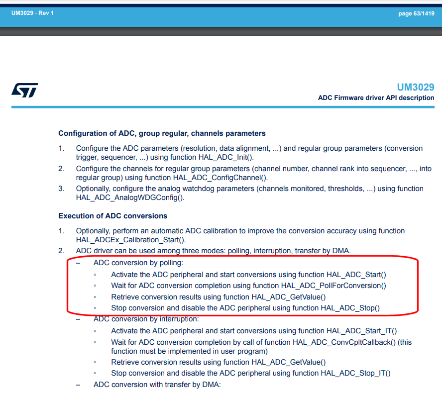

@Gaston wrote:
In this application I don't want to use DMA or Interrupts
So "Polling", then:
And how do you select the channel you want to convert? For example:
  • Select ADC channel 0
  • Start ADC conversion
  • Wait for EOC
  • Read ADC value
  • Stop ADC
  • Select ADC channel 4
  • Wait for EOC
  • Read ADC value
  • Stop ADC
