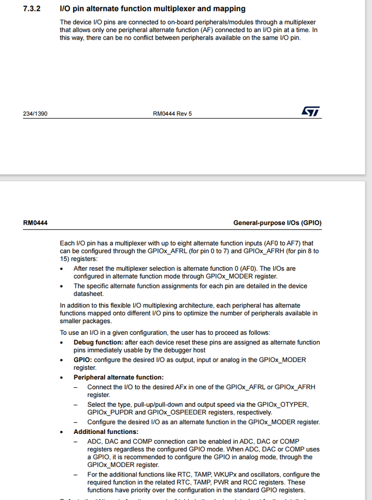

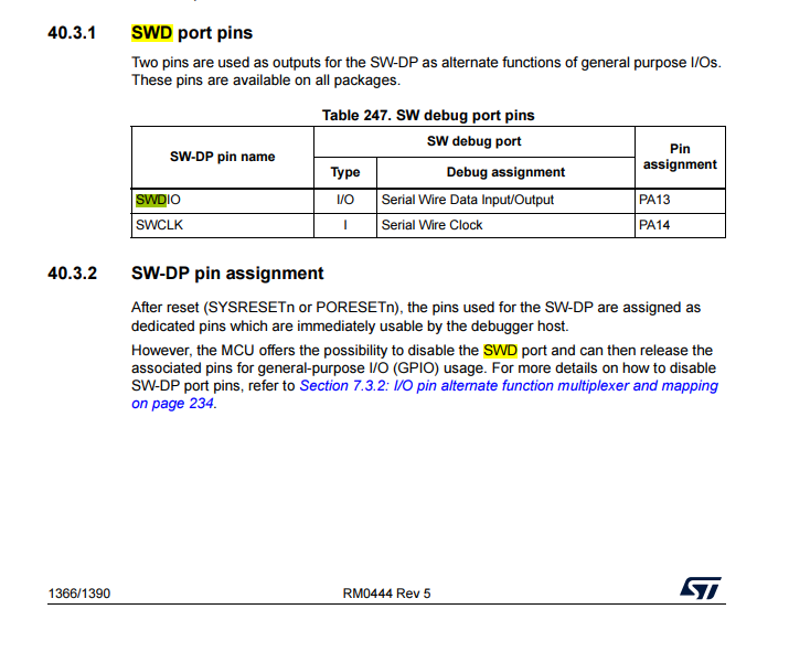

2022-10-10 12:22 AM
Hi @Community member and @Community member
I am not interested in using the NRST pin as GPIO but only the PA13 and PA14 as GPIO
So your opinions are that I should simply code them as GPIO without any other cautions? Neither on the debug side?
What I found in the manual does not help me a lot. Can you take a look at this?
