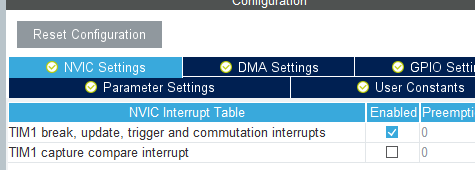

}I have enabled the NVIC :

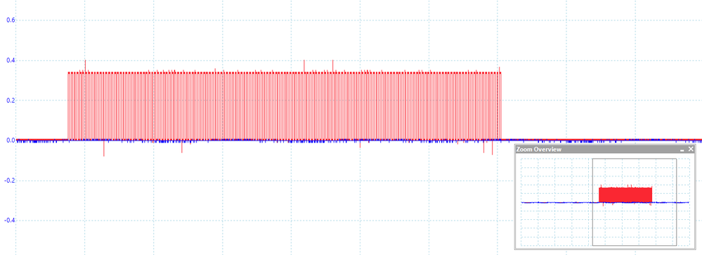

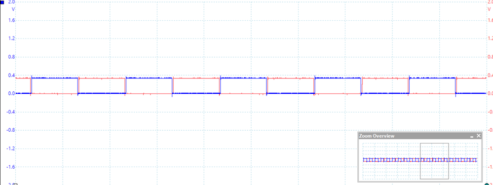

...I am expecting that after 150 pulses, the pair of pwm signals will stop.
After building the project, I set a breakpoint at previous code block, right before the HAL_TIM_PWM_Stop function.
__HAL_TIM_CLEAR_IT(htim, TIM_IT_UPDATE); // breakpointThen I start the debugging, when the program stops at here, I can see the PWM outputs , shown as below: if I resume the program, the output stops immediately.
If I remove the breakpoint, just let the program run, there is no PWM output at all. Even if I lower the frequency and increase the RCR, i still don't see any PWM output as soon as I launch the program.

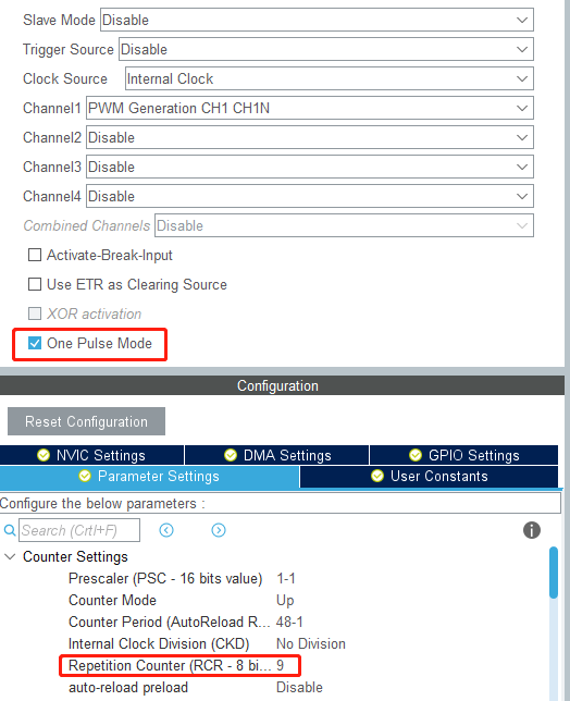

Hi,Thanks for your reply!
I tried the set up with only Onepulse mode + PWM completmentary output.
Simply as follow:
Only outputting PWM:
But there is still no PWM output at all from the start.
It seems that i'm still doing something wrong, can you give me some

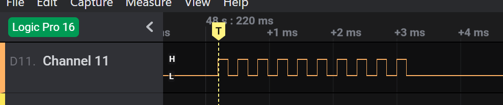

2020-11-18 2:09 PM
I'm not sure what the problem is, but I can get this working on the H743 by following the steps you're doing. I don't have an F0 board.
Here's the output showing exactly 10 (RCR + 1) pulses.
Here is the mostly CubeMX generated main.c file. Perhaps you can compare between yours to find the issue. This is the only line I added:
HAL_TIM_PWM_Start(&htim1, TIM_CHANNEL_1);It's also possible that this behaves differently on the F0 family and we're missing something.

2020-11-19 7:40 AM
Hi, thanks again for the reply!
I was setting the PWM output frequency at 1MHz, seeing your project I changed the frequency with your parameters.
And I did see the fixed amount of PWM pulses from my oscilloscope this time!:
which means the method does work! but probably 1Mhz + 10 pulses was too quick for me to observe.
Are you using a logic analyzer to capture the signal? May I know the part number?
