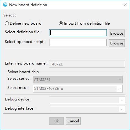

Hi shahrzad!
Thank your reply! In Ac6 System Workbench for STM32 environment,new board define have no jlink, my custom board use stm32f4xx.1 # This is an ac6_f4_std board with a single STM32F407ZETx chip.2 # Generated by System Workbench for STM3234 source [find interface/jlink.cfg]5 6 set WORKAREASIZE 0x200007 transport select ''hla_swd''8910 source [find target/stm32f4x.cfg]11 12 # use hardware reset, connect under reset13 reset_config srst_only srst_nogate fail to debug2015-09-14 8:31 AM

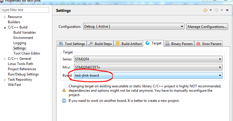

Hi wjandsq,
Ensure that you have selected a board for your project, otherwise the debug session will not run.2015-09-19 6:06 AM

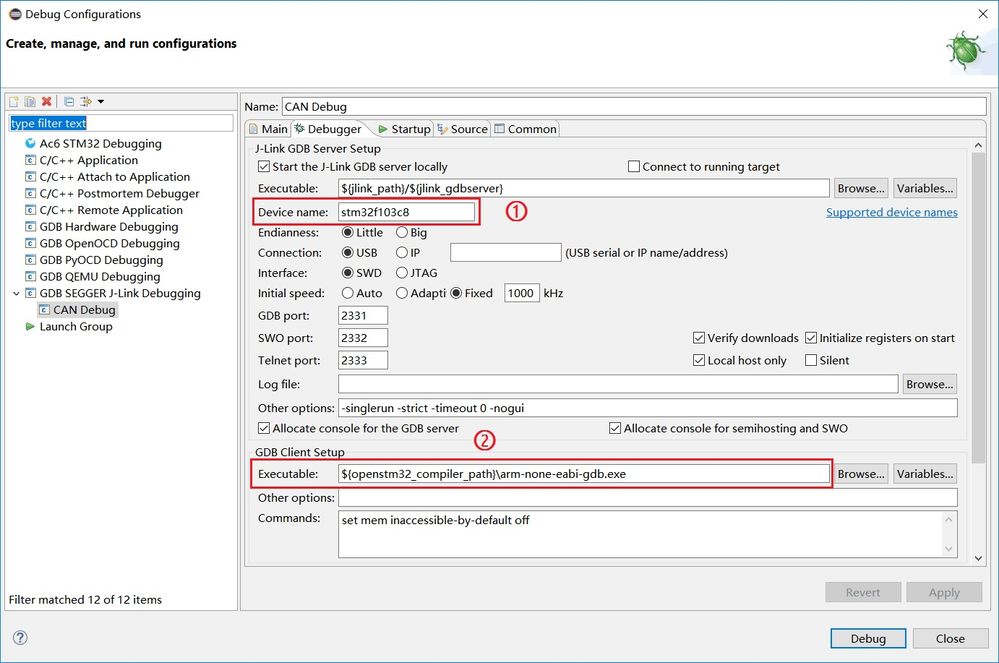

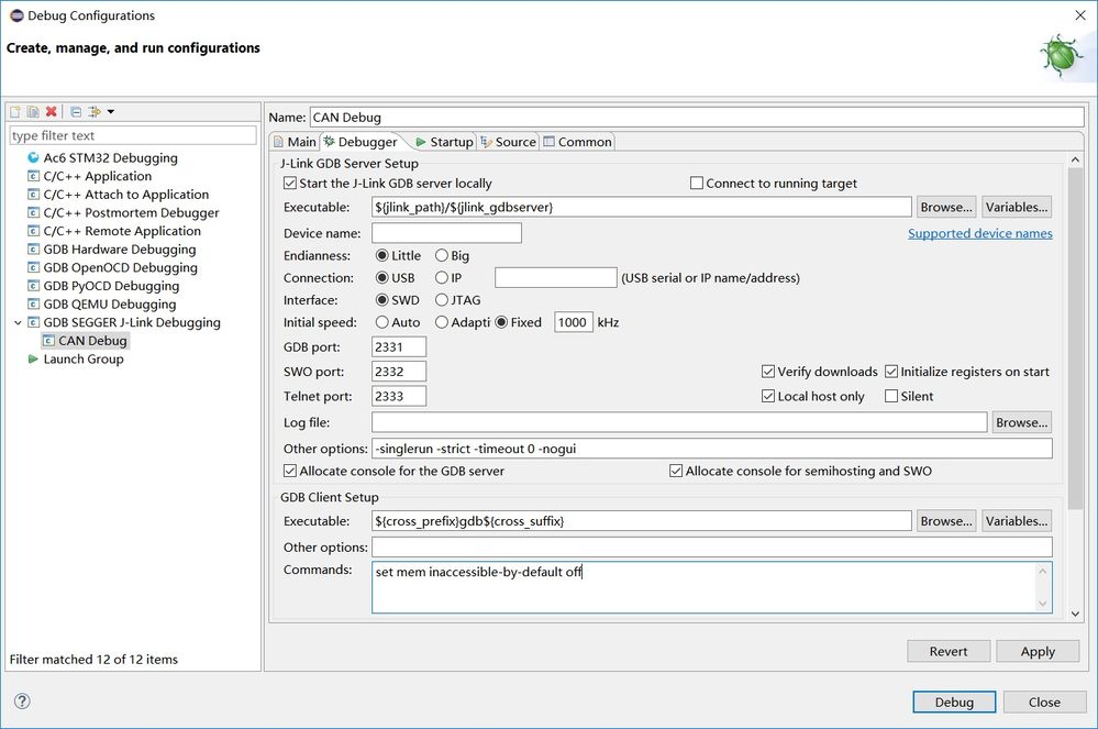

Ac6 use JLink Debug OK! the modify is
${openstm32_compiler_path}\arm-none-eabi-gdb.exe
