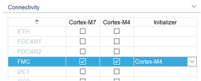

Both cores can use the SDRAM once it is initialized. If you want initialization to be done on the M4 core, assign it to that core within CubeMX.

I tried with this method its working fine. But I want to use external SDRAM as program data memory for M4, I tried for M7 core to use as program data memory by initializing the SDRAM in SystemInit() function. But for M4 core it is not working. Is it possible to use external SDRAM as program data memory for M4 core?
