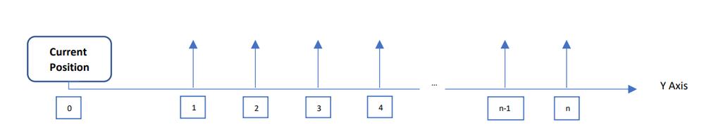

My application needs to generate pulses on specific encoder position like this :

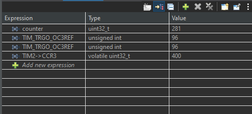

2022-03-04 8:11 AM
TIM2->CCR3 Register does get updated with __HAL_TIM_SET_COMPARE(&htim2,TIM_CHANNEL_3,400);
but I guess I am missing another Enable register or flag or something.

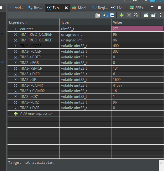

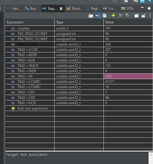

2022-03-04 8:46 AM
Continuing the adventures into TIM2 registers, here's what I found :
TIM2->SR has 1601 value in before I get to first trigger position
TIM2->SR has 1609 value after first trigger position.
I will study some more of this SR register but it seems like if I overwrite 1601 in it after updating CCR3 should work.
