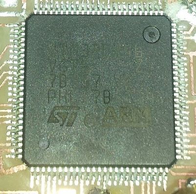

Hey everyone. I've just put together my first STM32F7 LQFP100 breakout board. I wanted to first try the STM32F7 Discovery board, but the camera connector doesn't support the OV5645.
I'm having trouble uploading flashing through SWD (I'm using a Segger JLINK, which keeps saying ''No device found on SWD''). I've successfully created and used a similar board based on the STM32F437VG before. The documentation said the pin out should be identical with the STM32F4, except for the bottom and left side rows, which I've changed.
How can I go about debugging this? I've already checked connectivity of all the power, VCAP, BOOT0, reset, and SWD pins.
Also, I'm not certain that the chip has the right orientation. The STM32F4 had a marker to show which corner was pin 1. Somehow the STM32F7 has 2 markers which is confusing (figure 80 in the manual still says pin 1 is at the bottom left corner when you orient the text correctly which is consistent with what I did for STM32F4).

Amel NASRI
Posted on September 28, 2015 at 13:19
Hi zhang.yale,
Yes you are right; the pin 1 is at the bottom left corner.

yzhang1985
Associate III
Posted on September 30, 2015 at 13:43
LOL - signs of life. I've found it. I'm measuring lots of neural activity, um I mean SWD in the 3V range.
So, what I did to debug the problem was to wire up the same circuit on a Schmart Board which should be more reliable. This time I connected VBAT & Vref+, and used a resistor instead of wire for BOOT to be safe. But SWD didn't work either. Manually soldering 0.5 pitch pins is inherently error prone and I had to reflow several flaky solder joints. I checked connectivity of the SWD pins using a DSO Quad oscilloscope. Then I changed the BOOT pin to 1 instead of 0, and then it miraculously started working. Switching BOOT back to 0 broke SWD again. I don't remember what I did at this point, probably reflow a few joints and wiping away soldering residue. After that, BOOT = 0 finally started functioning.
Wary of the soldering issues I encountered, when I tried my breakout board again, I soldered the SWD connections instead of using jumper wire connectors. This seemed to pay off and I now have a working board. Note, I did not have to connect VBAT or Vref+.
My tentative conclusion is that flaky solder connections caused my problems. It seemed the BOOT pin had something to do with it, but I think that was just a manifestation of bad soldering.
Posted on September 30, 2015 at 22:10
Yes, the STM32's are notoriously difficult to see if they are alive or dead when just statically powered, in days of yore you could see oscillators kick on, or boot loaders chirp, here you have to physically kick it.
Electrically the things to look at are the state of the NRST/NRESET pin, and the VCAP pins for the internal regulator kicking on.
I think the biggest circuit gotchas are the analogue supplies, and regulator bypass, and leaving the BOOTx pins floating.
