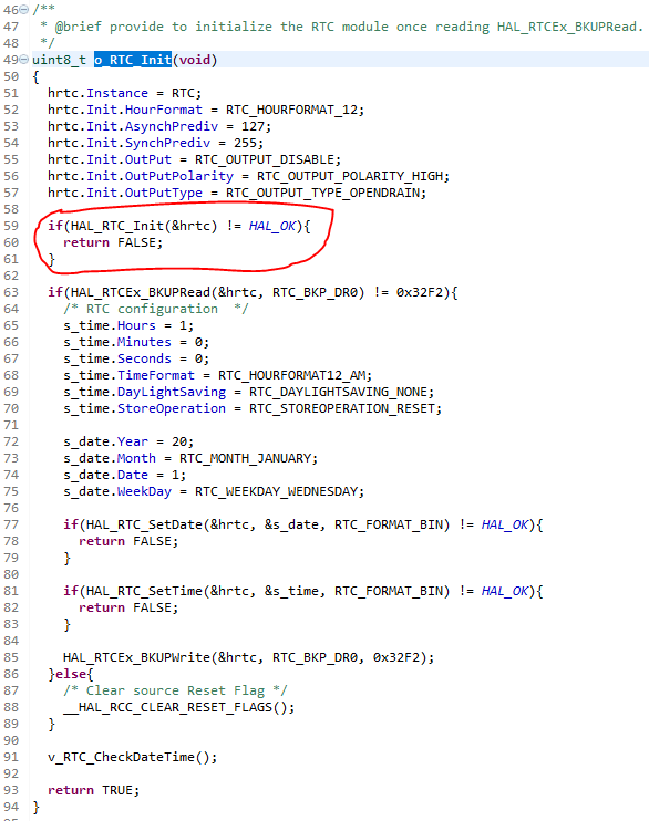

First, if you are Cube, make sure this is not consequence of the unnecessary initialization (that would delay the clock half a second in average per reset).
Slow/fast running oscillator can be compensated digitally within RTC, read RTC smooth digital calibration subchapter in RM; but maybe you should tweak the load capacitors first to get closer to nominal. Read AN2867.

I use it as shown in the picture below. Is there any problem for this structure ? I guess the block I marked creates a delay every time I run the main function, is it right ?
thanks in advance.
