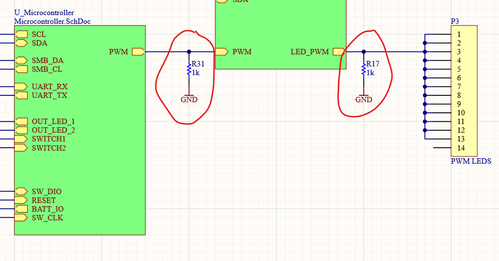

I already have an pull-dowm resistors.
2022-06-01 6:16 AM
That should be then OK from the STM32 side.
This may be inherent problem of the LED driver. Try to disconnect it from STM32 and switch off/on - does it still blink?

Is there any update? Same problem for me. Pull-down resistors did not solve the problem.
