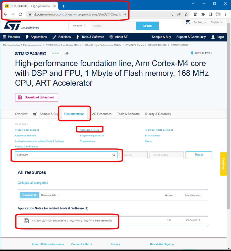

2022-05-04 6:38 AM
https://www.st.com/en/microcontrollers-microprocessors/stm32f405rg.html
2022-05-04 6:39 AM
You can store memory to flash, which is retained through power resets. There is an EEPROM emulation library you can search for. People often use the last (or last two) pages in flash to do this.
