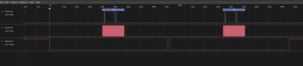

I need to transfer a large amount of bits over SPI de-asserting/asserting the select line very 64 bits. I'm using DMA. The time between transmissions is huge, as can be seen below:
The pink channel is SCK, each chunk is 64 bits. The code is below:

2023-02-20 10:04 AM
Don't use Cube/HAL.
Increase optimization level of compiler.
You could generate complex waveform of SCK/NSS using timers in master-slave arrangement, and feed them back to SPI used as slave.
2023-02-20 2:45 PM
If sending 2 blocks of data bidirectionally, use TXE, and "RXNE" at the end of all data transfer.
DMA setup takes time in HAL... you already use LL for GPIO, use HAL for GPIO and compare them.
Some STM32 have HW 32 bit FIFO on SPI, some other STM32 have linked list DMA which could make intra data packet delay down to nearly zero remains the time from NSS down to SCK toggles, and SCK stop to NSS up delays.
2023-02-20 2:52 PM
And one general note: The way you code as bare metal won't scale well if you have multiple SPI in your application (and in the MCU), as it will be time multiplexed. If you want all SPI (and other serial interfaces) to work in // , you'll need to use interrupts.
