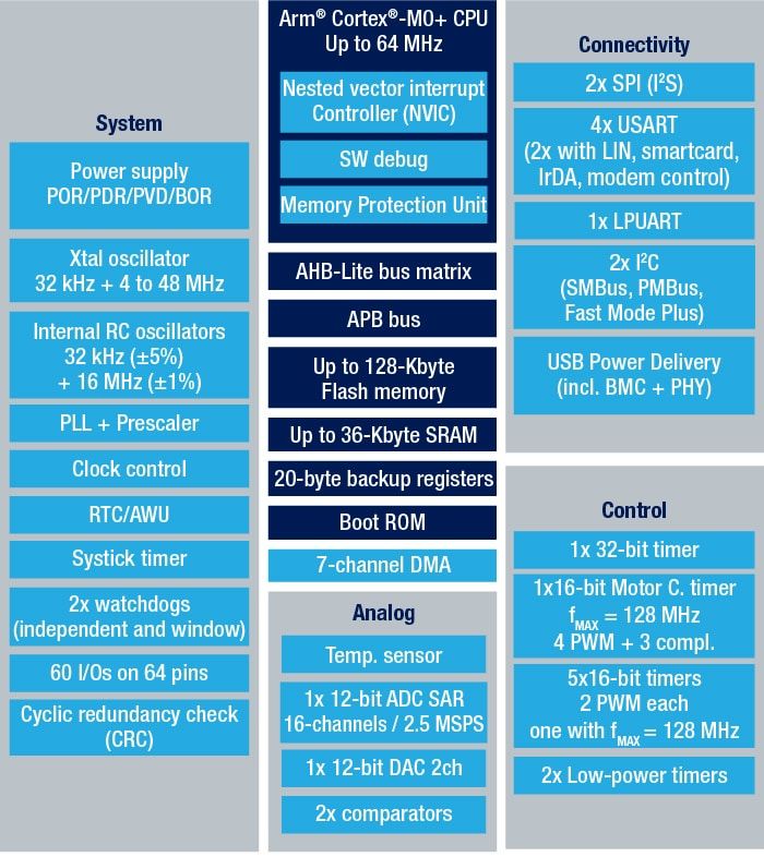

Note that the STM32 has to have multiple ADCs, this model you mentioned seems to only have 1 ADC (1x 12bits ADC). It would have to read one channel (ANALOG PIN) at a time.
https://www.st.com/en/microcontrollers-microprocessors/stm32g071rb.html

But it says, 16-channels like in DAC where it has 2 channels. I used two DAC channels successfully.
It should be able to read sequentially inside the timer, I assume? Maybe my question was a bit misleading. But thanks for the video, i did check it out and will try now. Hopefully, will work.

I believe there was a mistake, DAC is used to input a Digital value and output an Analog value. When the input is Analog and the read value is Digital, the ADC is used.
This channel part is really confusing, but it's like this: there are 16 input channels, but only 1 ADC. So this STM32 model has to read one channel at a time. For example this image of 1 ADC and 8 input channels:

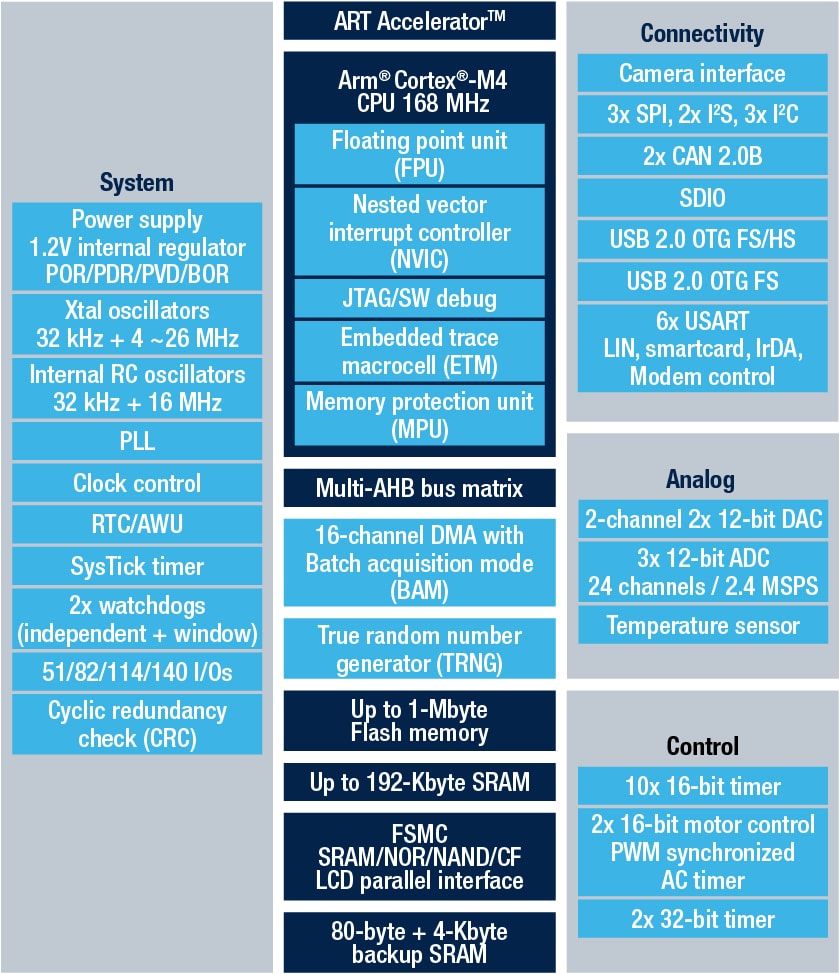

For example the STM32F405OE has 3 ADC and 24 channels. In this way it is possible to read 3 channels at the same time:

Hmm okay.
As i understand these three adcs can read values simulatenously.
In my case, it's fine for me if the same adc with two different channels read values sequentially because I assume the HAL get value is fast enough that i can read two values within 50KHz. If that's possible, but when I tried that it's giving me weird value as I posted in another comment.
If this is unavoidable with my stm then I have no other choice than drop this idea.
