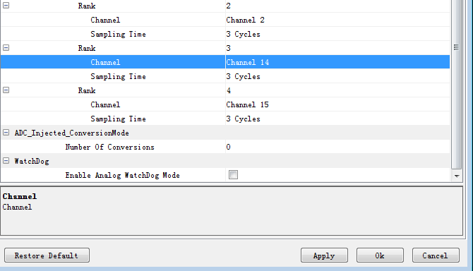

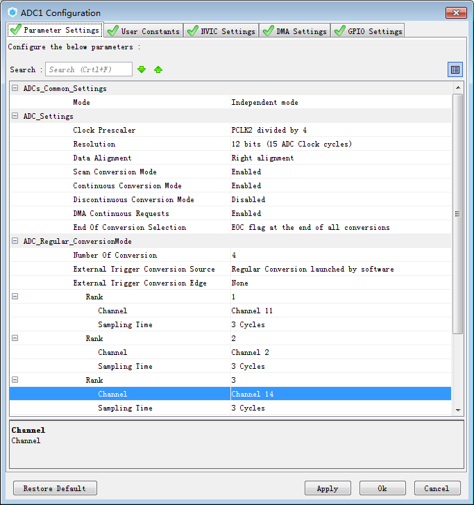

2017-04-15 3:54 AM
Posted on April 15, 2017 at 12:54
Use DMA Mode to read multi-channel-adc looks fine,
for example
PC1 ------> ADC1_IN11,
PC4 ------> ADC1_IN14,
PA2 ------> ADC1_IN2,
PC5 ------> ADC1_IN15:
1. ADC Initial : for channel with 4 different rank
/* ADC1 init function */
static void MX_ADC1_Init(void)
ADC_ChannelConfTypeDef sConfig;
/**Configure the global features of the ADC (Clock, Resolution, Data Alignment and number of conversion)
hadc1.Instance = ADC1;
hadc1.Init.ClockPrescaler = ADC_CLOCK_SYNC_PCLK_DIV4;
hadc1.Init.Resolution = ADC_RESOLUTION_12B;
hadc1.Init.ScanConvMode = ENABLE;
hadc1.Init.ContinuousConvMode = ENABLE;
hadc1.Init.DiscontinuousConvMode = DISABLE;
hadc1.Init.ExternalTrigConvEdge = ADC_EXTERNALTRIGCONVEDGE_NONE;
hadc1.Init.ExternalTrigConv = ADC_SOFTWARE_START;
hadc1.Init.DataAlign = ADC_DATAALIGN_RIGHT;
hadc1.Init.NbrOfConversion = 4;
hadc1.Init.DMAContinuousRequests = ENABLE;
hadc1.Init.EOCSelection = ADC_EOC_SEQ_CONV;
if (HAL_ADC_Init(&hadc1) != HAL_OK)
Error_Handler();
/**Configure for the selected ADC regular channel its corresponding rank in the sequencer and its sample time.
sConfig.Channel = ADC_CHANNEL_11;
sConfig.Rank = 1;
sConfig.SamplingTime = ADC_SAMPLETIME_3CYCLES;
if (HAL_ADC_ConfigChannel(&hadc1, &sConfig) != HAL_OK)
Error_Handler();
sConfig.Channel = ADC_CHANNEL_2;
sConfig.Rank = 2;
Error_Handler();
sConfig.Channel = ADC_CHANNEL_14;
sConfig.Rank = 3;
Error_Handler();
sConfig.Channel = ADC_CHANNEL_15;
sConfig.Rank = 4;
Error_Handler();
}2. DMA Initial : DMA NVIC
* Enable DMA controller clock
static void MX_DMA_Init(void)
/* DMA controller clock enable */
__HAL_RCC_DMA1_CLK_ENABLE();
__HAL_RCC_DMA2_CLK_ENABLE();
/* DMA interrupt init */
/* DMA2_Stream0_IRQn interrupt configuration */
HAL_NVIC_SetPriority(DMA2_Stream0_IRQn, 0, 0);
HAL_NVIC_EnableIRQ(DMA2_Stream0_IRQn);
}3. MSP initial : adc' GPIO
void HAL_ADC_MspInit(ADC_HandleTypeDef* hadc)
GPIO_InitTypeDef GPIO_InitStruct;
if(hadc->Instance==ADC1)
/* USER CODE BEGIN ADC1_MspInit 0 */
/* USER CODE END ADC1_MspInit 0 */
/* Peripheral clock enable */
__HAL_RCC_ADC1_CLK_ENABLE();
/**ADC1 GPIO Configuration
GPIO_InitStruct.Pin = GPIO_PIN_1|GPIO_PIN_4|GPIO_PIN_5;
GPIO_InitStruct.Mode = GPIO_MODE_ANALOG;
HAL_GPIO_Init(GPIOC, &GPIO_InitStruct);
GPIO_InitStruct.Pin = GPIO_PIN_2;
/* Peripheral DMA init*/
hdma_adc1.Instance = DMA2_Stream0;
hdma_adc1.Init.Channel = DMA_CHANNEL_0;
hdma_adc1.Init.Direction = DMA_PERIPH_TO_MEMORY;
hdma_adc1.Init.PeriphInc = DMA_PINC_DISABLE;
hdma_adc1.Init.MemInc = DMA_MINC_ENABLE;
hdma_adc1.Init.PeriphDataAlignment = DMA_PDATAALIGN_HALFWORD;
hdma_adc1.Init.MemDataAlignment = DMA_MDATAALIGN_HALFWORD;
hdma_adc1.Init.Mode = DMA_NORMAL;
hdma_adc1.Init.Priority = DMA_PRIORITY_LOW;
hdma_adc1.Init.FIFOMode = DMA_FIFOMODE_DISABLE;
if (HAL_DMA_Init(&hdma_adc1) != HAL_OK)
Error_Handler();
__HAL_LINKDMA(hadc,DMA_Handle,hdma_adc1);
/* USER CODE BEGIN ADC1_MspInit 1 */
/* USER CODE END ADC1_MspInit 1 */
}4. Read Multi-ADC-Channel to memory
static uint16_t adc_buffer[4];
hadc1.Init.NbrOfConversion == 4
if(HAL_ADC_Start_DMA(&hadc1, (uint32_t*)&adc_buffer, hadc1.Init.NbrOfConversion) != HAL_OK);
HAL_Delay(500);
HAL_ADC_Stop_DMA(&hadc1);
and add what you want in completed callback function:
* @brief Conversion complete callback in non blocking mode
* @param AdcHandle : AdcHandle handle
* @note This example shows a simple way to report end of conversion, and
* you can add your own implementation.
* @retval None
void HAL_ADC_ConvCpltCallback(ADC_HandleTypeDef* AdcHandle)
// TODO
__NOP();
