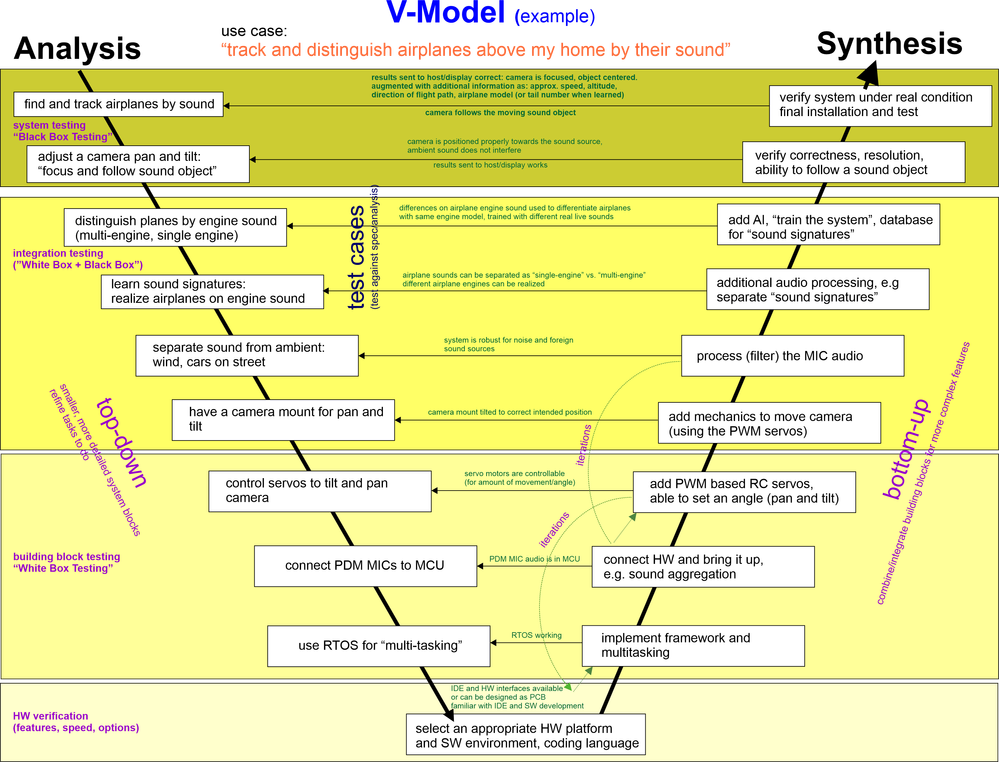

When it comes to "system design" - for my feeling (experience)
In case of your sensor: you have to "learn", study fundamental things first before starting any coding. For instance: what is this "single wire interface"?, how does it work? how could you test/verify when building/programming? which HW support is there? what would you do in SW? how would you do in SW? ...
It is not magic. It is just an "organized way" to "analyze" and "synthesize". Not jumping ahead and if something is not really clear what and how: iterations (go back a bit again and maybe try to find another, better, easier way).
