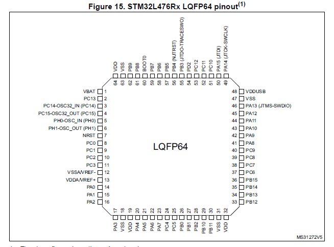

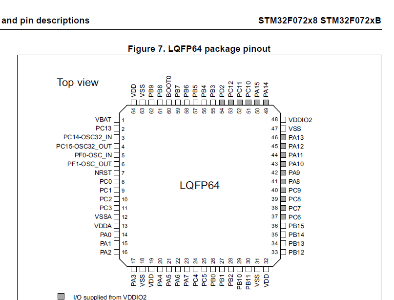

Hi Berendi,
Hereby attaching the pinouts of both L476 and F072. STM32F072 is having less peripherals than the L476 IC. I want to use the peripherals which is there in stm32f072. I want t0 migrate the code written for the L476 to F072.
2020-02-26 3:04 AM
These figures don't cover the possible alternate functions.
The first step is to check the GPIO alternate function settings of your application on the L4, and find out whether the same peripheral functions are available on the F0 on the same pins.
2020-02-26 3:27 AM
Yes sir I have checked that also. The peripherals which I wanted is same in both of the controllers. I would like to know how to convert the code which is in L4 to F0 in cube ide.
