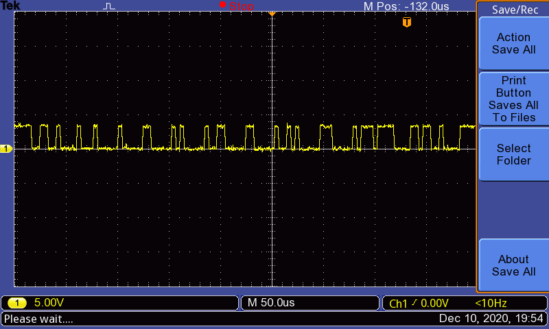

I can able to do "Loopback Mode" and I'm getting the desired output signal(CAN_TX). When I opted "Normal Mode" I can not see any output signal at TX pin.

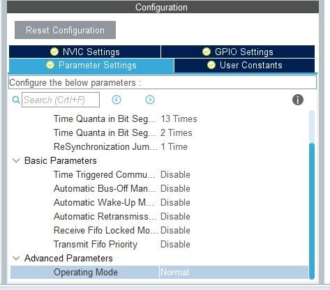

Here I have selected polling method only and not used any of the interrupt(eg:CAN1_RX0,TX Interrupt). My "BIT Timing Parameters" and LoopBack Output are as shown in the image.
