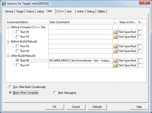

After Build/Rebuild, Run ♯ 1
, figure you are processing the .AXF after the linker has generated it. Pretty sure there is documentation.2017-11-06 7:59 PM
Keil has a FromELF utility, you can run it from the user tab to build a .BIN file.
$K\ARM\ARMCC\bin\fromelf.exe --bin --output=@L.bin !L

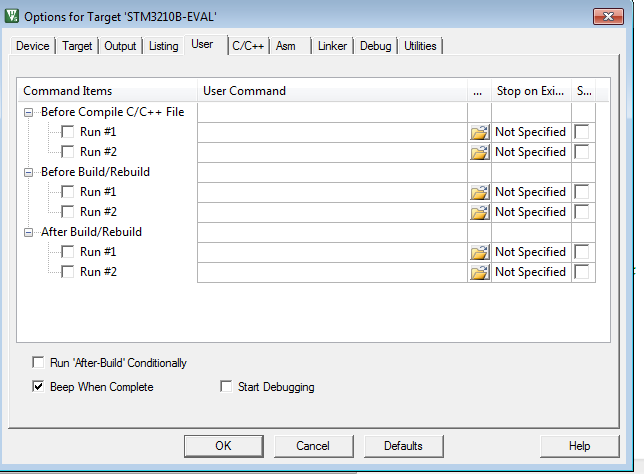

Would you mind let me know what should I do for applying ''
$K\ARM\ARMCC\bin\fromelf.exe --bin --output=@L.bin !L''?
2017-11-06 9:23 PM
