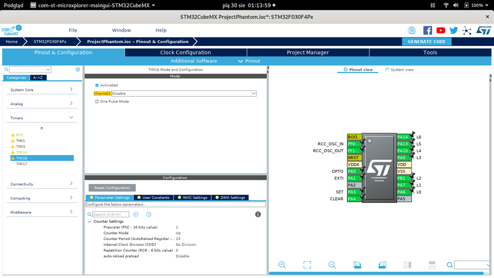

Im using F030F4P6 controller. Here's TIM16 configuration:

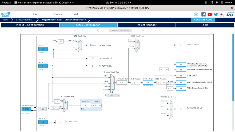

Here's clock configuration:

htim16.Init.Prescaler = 1; // Needs to be MHz of TIMCLK -1 (here assumes TIMCLK = 2 MHz, is that correct?)
htim16.Init.CounterMode = TIM_COUNTERMODE_UP;
htim16.Init.Period = 23; // Needs to be maximal, ie 0xFFFF
