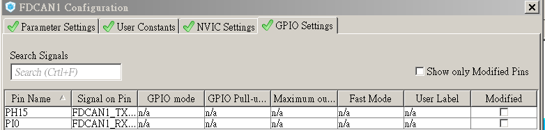

2017-09-18 8:30 PM
I was already using STM32CubeMX 4.22.1 and STM32Cube FW_H7 V1.1.0.
The CubeMX suggested me using PH15 and PI0 but did not generate any setting for those GPIOs.
So I added some code and set those GPIOs as ''Alternative Function 9 (FDCAN1)'', but they did not work.
Besides, I was wandering why those settings are ''n/a'', does that means the hardware is not ready for using yet?
Thank you for the response, and please let me know if you have any further thought.
