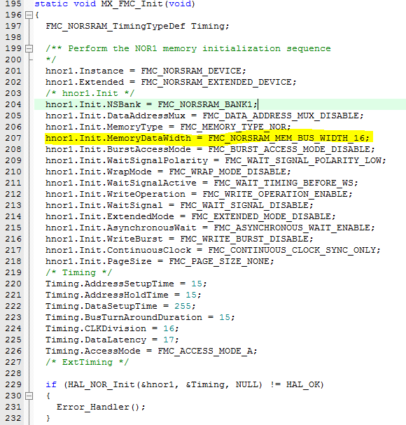

Yes, you can define the bus width of the FSMC bus, it won't increase the decoded region in memory, it simply shifts the address bits presented to the physical device.
For a memory larger than the 64MB decode window, you'll need to use TWO different decode regions and add glue logic to combine them at the device. ie drive the chip select as a combination of the two, and drive order address bit high or low depending on which one.

You'd need to AND a pair of -CS pins to drive the chip select on the memory, then a high order address bit could be one of the selects, being either 0 or 1 depending on the bank.
Each address in the ARM is a BYTE, when you configure the STM32 FSMC in 16-bit data mode it shifts the address bus as presented at the pins, thus A[0..25] at the pins are A[1..26] internally

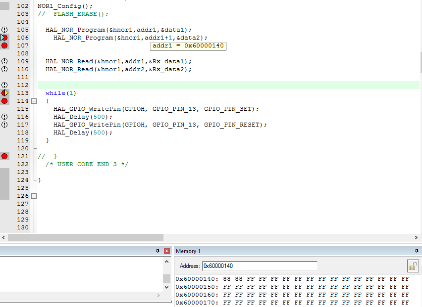

say i write 0xAAAA to location 0x0000000
, 0xCCCC to location 0x0000001
,0xFFFF(default) in location 0x0000002
it should be saved as AAAA , CCCC
but the data is stored as 0x8888 in location 0x0000000 which is the AND of 0xAAAA and 0xCCCC.
and if i read 0x0000001 location the data that i recieve is 0xFF88
So clearly, one write operation of a 16bit word is taking two address space.
and the contradicting issue is that, i cant go beyond 0x63FFFFFF also
because of this reason

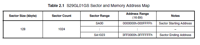

i'm stuck with only 0x00 to 0x3FFFFFF addresses and i have to make use of only these numbers to address the entire 1Gbit Flash, ''
'', yea so each incremental address is pointing to a byte. which is exactly 2^26 bytes, and tats only half of the memory!!!!2017-11-17 6:05 AM
You'd have to write 16-bit words two bytes apart
[0x60000140] = 0xAAAA
[0x60000142] = 0xCCCC
Like I said, you'd need to combine two decode regions, this would require simple external logic.
